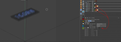

Hi Ahmet. Enabling the Level of detail option in cloner causes a crash when render go to next frame in PictureViewer. Single frames render normal. Please check the file that I attached for you.

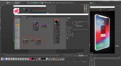

Ahmet, octane stop update image sequence in material when i connect falloff node setup to opacity channel. Please fix this bug. Just Falloff node disable sequence update same.
https://yadi.sk/i/TP4AQHiwun2kcg
Posts: 16067
Location: Türkiye
divasoft wrote:Ahmet, octane stop update image sequence in material when i connect falloff node setup to opacity channel. Please fix this bug. Just Falloff node disable sequence update same.
Try to recreate it in a new scene for testing, it's not reproducible on my tests. Your material or scene can have a specific glitch. Or the location of image sequence.
