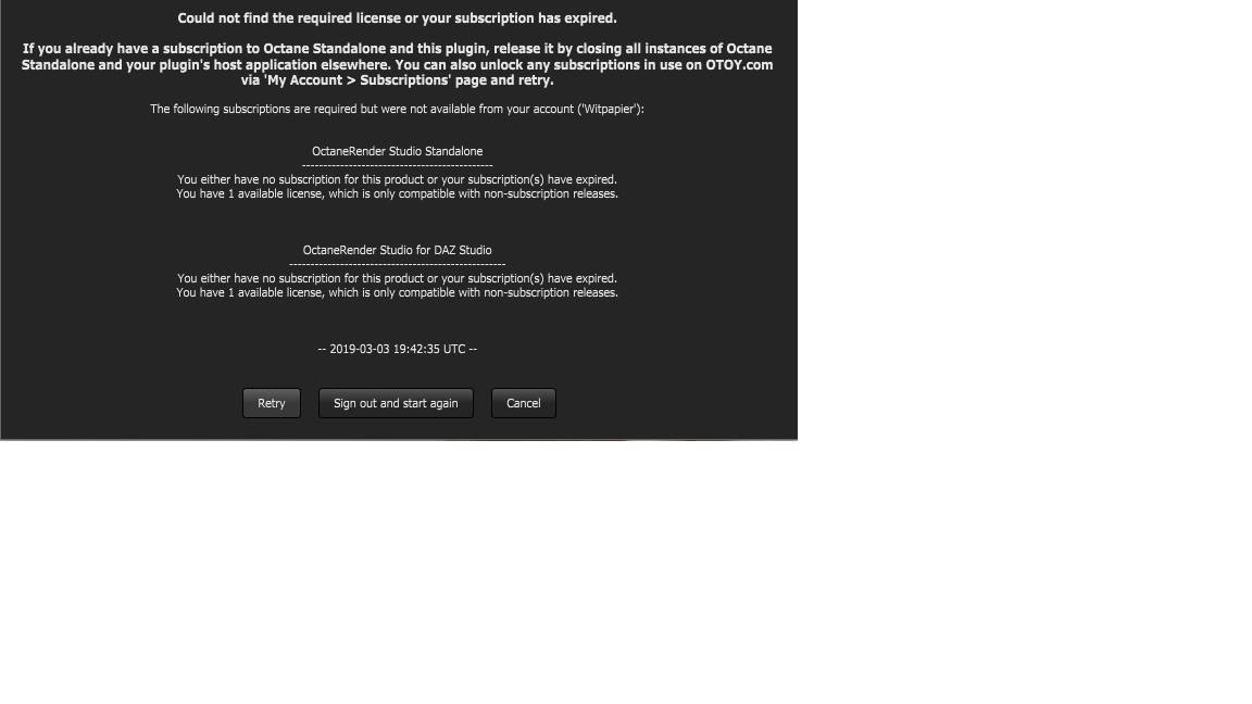

I get this error with the new version. I downloaded regular and get this error, (does the same with the subscription build)
If you are upgrading from version 3 you will need to "buy" the upgrade to version 4, which should be free for you. If you are already using version 4 and getting that error than I dont know.
