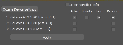

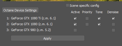

ramone163
Posts: 263
Joined: Tue Aug 28, 2012 5:12 pm
I have 2 monitors connected to 980. And 1080 + 1080Ti for rendering.
If i disable only 980, Material editor slow. If I disable also 1080, Material editor - normal speed. Why 1080 affects on 3ds Max preview speed if it is not connected to monitors? Or how it works?
Material Editor normal speed while rendering
Material Editor slow while rendering
