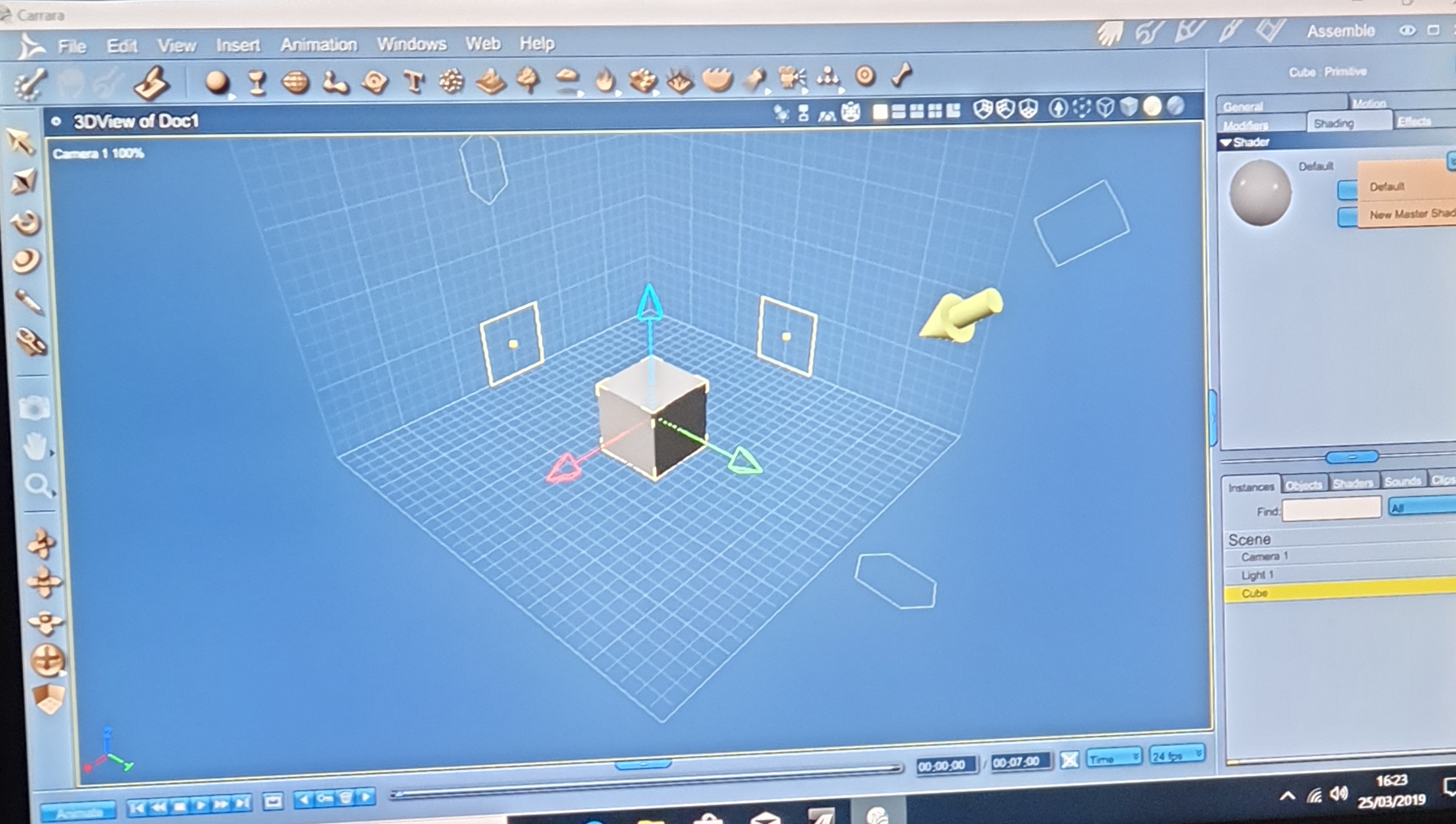

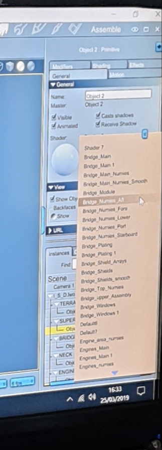

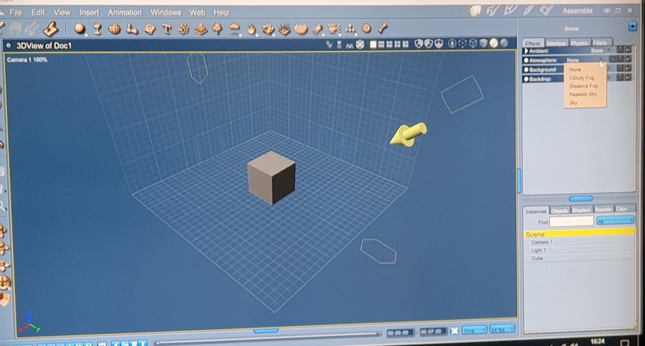

I've the latest plugin installed 402.01.07 the glow function works again for lights didnt before, the problem is when plugin is installed modifier tabs, atmosphere tabes wont drop down they do when its not installed?

This works well, a good version, glow material now works in the multi channel shader
, the problem i had with dropdown mens not working full screen works when carrara is half screened, this is down to doing a clean install of graphics driver where you lose screen settings , created a profile with "nvidia profile inspector" so i can install new graphics driver then apply settings.
