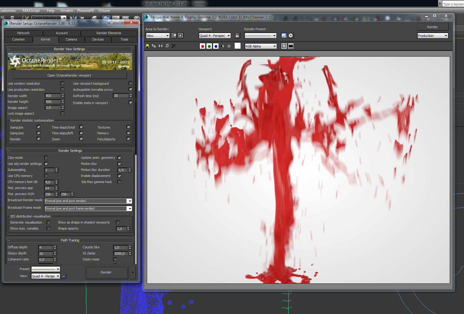

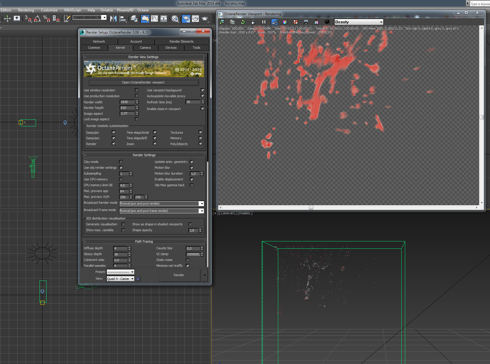

have at look at the attached video. Some interesting things going on here.

last video. This shows me opening an old file which previously did render correctly, and now resimulating. You can see where it renders the old cache files motion blur appears, but dissapears when overwritten with the new cache file.
I just cant seem to diagnose exactly where this is going wrong.
