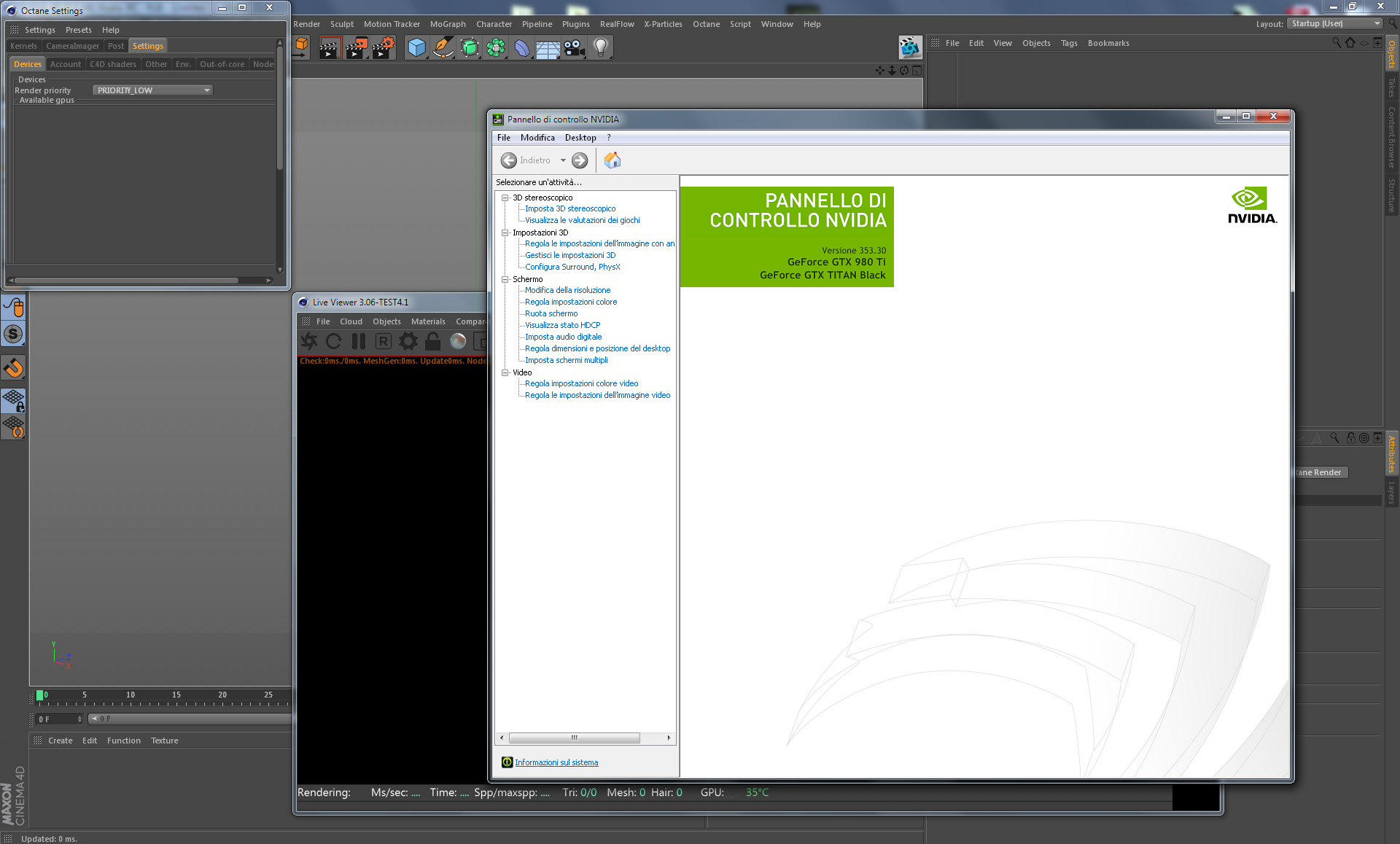

Weird, this latest version doesn't see my cuda devices, I've never had this kind of problem before, I went straight from 3.05.3 to 3.06-4.1
I'll try to update my nvidia drivers, even if 353.30 should work. Thank for this update, Ahmet, looking forward to test it out.

Domenicozzo wrote:Weird, this latest version doesn't see my cuda devices, I've never had this kind of problem before, I went straight from 3.05.3 to 3.06-4.1
Domenico
Pls check with more recent drivers. This version need cuda 8.0 and don't know but propably yours is not having that.
Domenicozzo
Posts: 44
Joined: Sun Jan 05, 2014 5:06 pm
Yes, the new drivers fixed the issue. I've tried some scenes and this version looks much faster when loading the geometry: excellent job, Ahmet!
