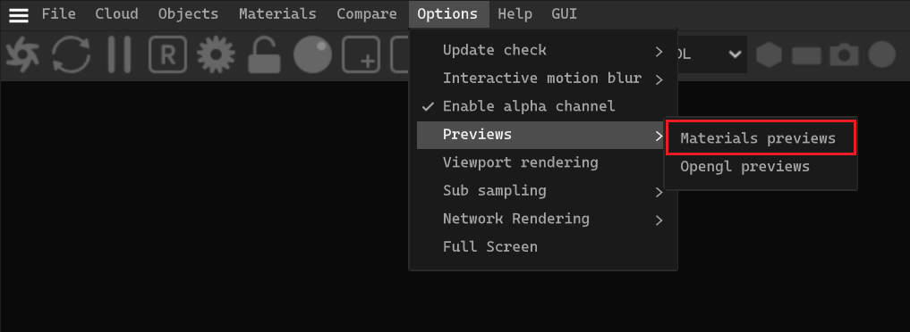

W_RTF
Posts: 16
Joined: Mon Apr 20, 2020 1:57 am
Request a script to turn octane material preview on or off
I am a Python beginner, where can I find the octane api, can anyone give me some Pointers
Posts: 16067
Location: Türkiye
W_RTF wrote:Request a script to turn octane material preview on or off
There are not an Octane API to use. All access are done by using data containers by using parameter IDs. These parameters are not accessible by any data, internal to software.
W_RTF
Posts: 16
Thanks for your reply, mainly when adjusting the material, rendering the material ball will cause IPR slow, so I want to write such a script
Posts: 16067
Location: Türkiye
W_RTF wrote: Thanks for your reply, mainly when adjusting the material, rendering the material ball will cause IPR slow, so I want to write such a script
What's the advantage of it over manually switch off from menu?
