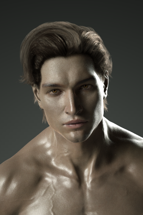

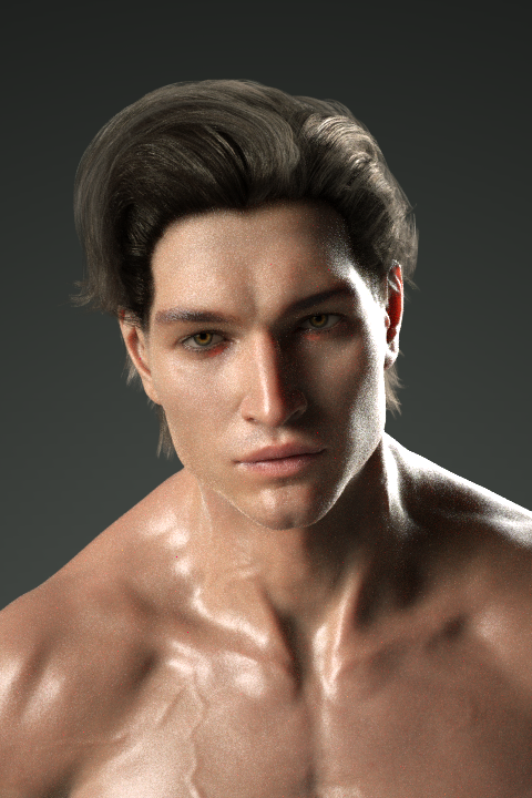

Did something change about specular materials? I opened a file I was working on yesterday which looked fine, and I downloaded and installed the latest standalone and test release and now the skin is rendering like...gray/black >_>
I switched back to 3.2.0.23 and my skin shader renders fine now. Will do some renders to show what I mean.
Sorel
Posts: 280
Joined: Tue Feb 25, 2014 5:22 pm
Here are the differences I mentioned. All settings are the same for each picture, just the versions of the plugin are different.
3.3.3.24/3.3.4.25
3.3.3.24/3.3.4.25
3.2.0.23
3.2.0.23
Sorel
Posts: 280
Ok I see what has happened. Before if you didn't want absorption you could just leave it at none, but now it HAS to have a color or else...you get the results I was getting.
Yes, I found the same - you need an absorption in order to get SSS working.
