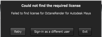

For the past few days, I haven't been able to use octane for maya due to "could not find the required license...." The first time, I manually deactivated it, then it worked. However, it did it again, and hasn't solved itself. Seems like it's not releasing the license.

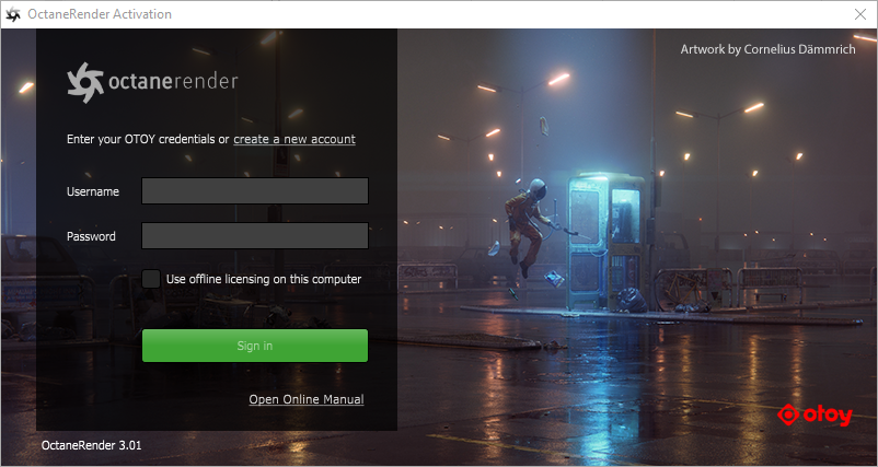

With manual deactivation you mean this:
This should only be necessary when you check "Use offline licensing on this computer" here:
We checked your license info on our side, looks fine, but tells me you run the plugin based on SDK 3.02.
I just updated the download and did not do a new post for it, but its now based on SDK 3.03.1. Maybe thats the issue.
Else could you reproduce the issue, leave it like that and tell us, so we can check on our side please?

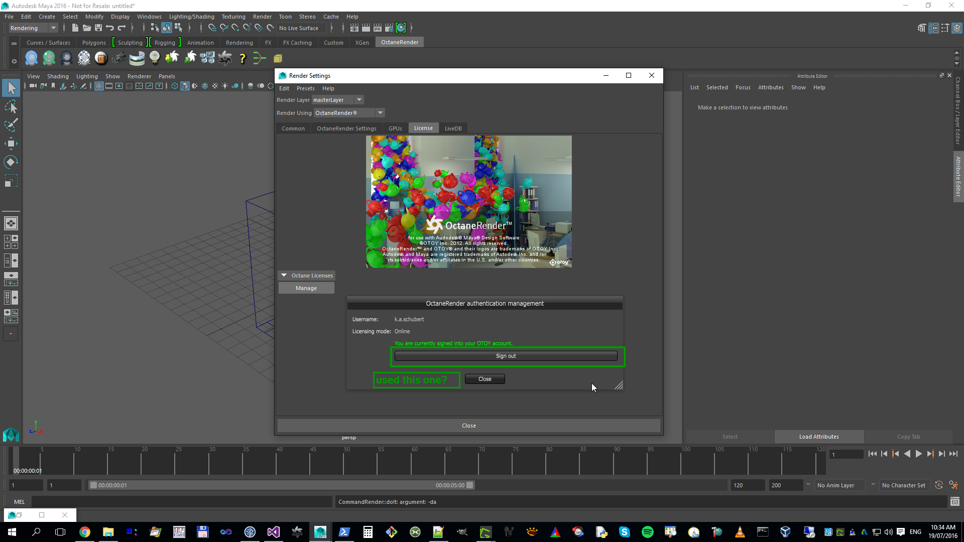

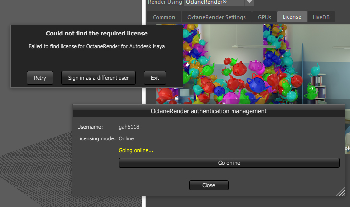

here is what is happening now.
when starting maya (which autoloads the plugin)

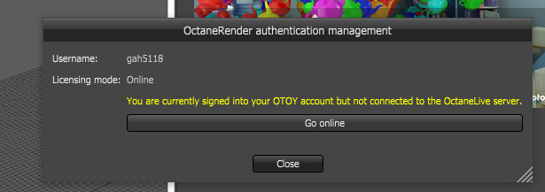

I open the render settings and go to the license tab and click manage
after clicking go online

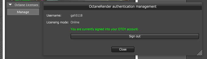

afterwords, it says I am now signed in.
However, its saying it's not activated
// Error: OctaneRender is not activated!
I have tried loading multiple times with the same results.
tried it with 2014 also... same issue.
UPDATE
I was able to fix the issue by going into my account and manually deactivating the license (3 more left). Seems like sometimes it hangs.
