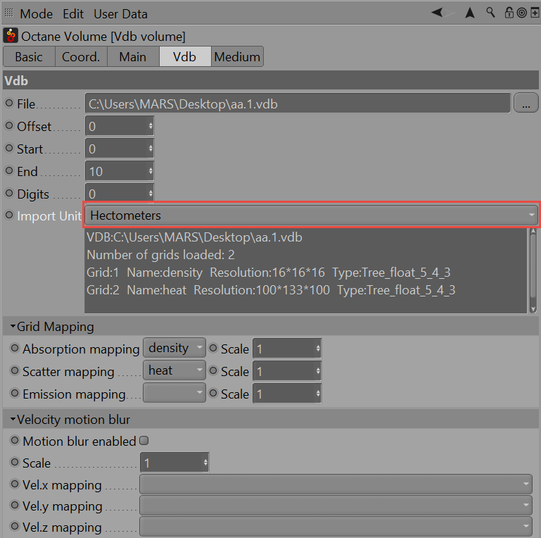

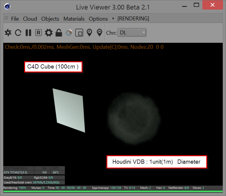

Most people will use Houdini to create openVDB.
Houdini 1unit is 1Meter.
C4D Default Unit is Centimeter.
VDB loader default scale is Meters. But Not Match Scale Houdini VDB. Hectometers is Matched Scale.

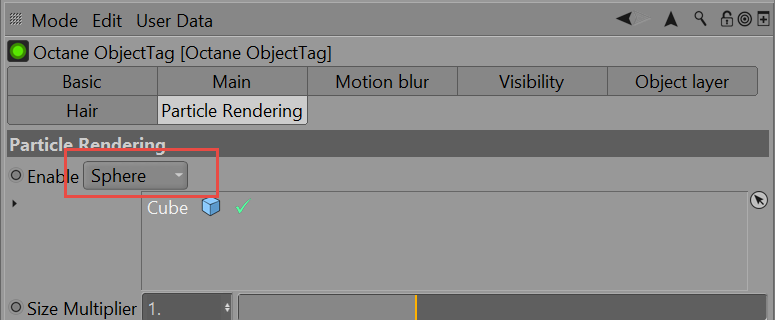

Particle Rendering - Dropdown Menu
I want to be a little change .
1.None
2.Sphere
3.Object Instances
4.Voxel
Thanks..... :D

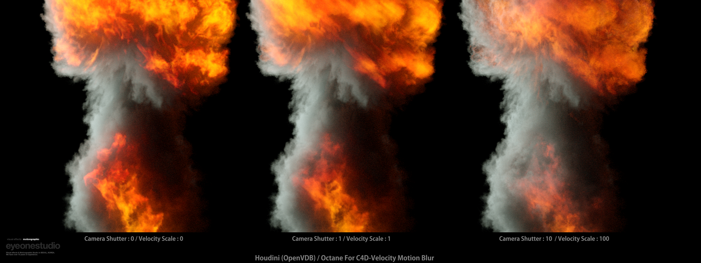

OpenVDB Velocity Motion Blur Testing
C4D R2026 / Win11 / AMD TR WX Series / 256Gb RAM / RTX 5090 FE / 100GbE
Posts: 16068
Location: Türkiye
eyeonestudio wrote:OpenVDB Velocity Motion Blur Testing
all good?
