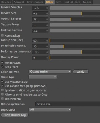

In that instance, I also needed to turn OFF "Synchronization on geo updates" ... not sure if this is related, in the current version I do not have the "Synchronization" button checked based on your recommendation and the manual.
Also not sure if changing "LV refresh time" or "Performance Timer" would make any difference ... I may take a look at these when I have the big spacestation loaded but since the file I sent you is small, I don't think this will make a difference.
from your 2.23 release notes I see that " parameter "Performance timer" in settings->other.Low values is well for updating in LV, but higher is better for editing the objects of complex scenes in viewport. "
