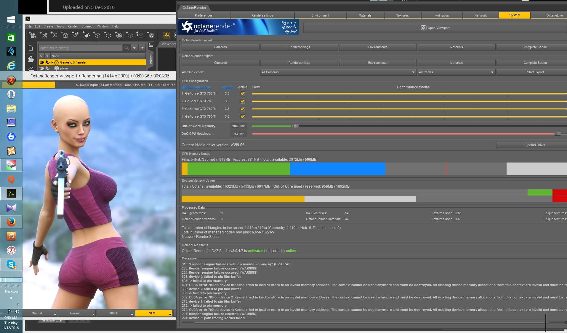

Ive been getting this errorwith the last 4 or 5 updates and its getting more frequent. If you look at the image at the bottom where it says messages you will see the sequence of the error messages. this happens under PMC and Pathtracing Kernel, I thought it might be something to do with overheating or driver crashes but none of the sorts. when I close Daz and start again everything works well. hope you can help me with this. Thanx again!

Looks like a faulty card. The most important log message will be for the first one (scroll down to the bottom of the log). Have you tried turning off one or more of your cards to identify which might be causing the issue?

I have actually disabled the Gigabyte GTX780 ti GHZ edition, and so far so good.... Seems they are pushed a bit far on the overclocking, Ill test and just make sure.... Thanx Paul.
