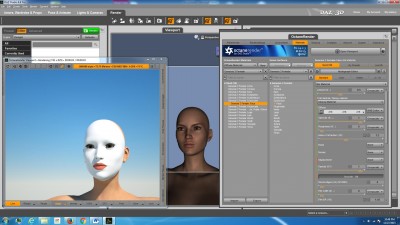

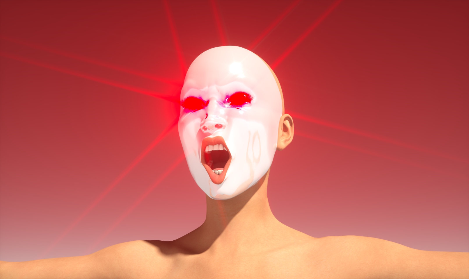

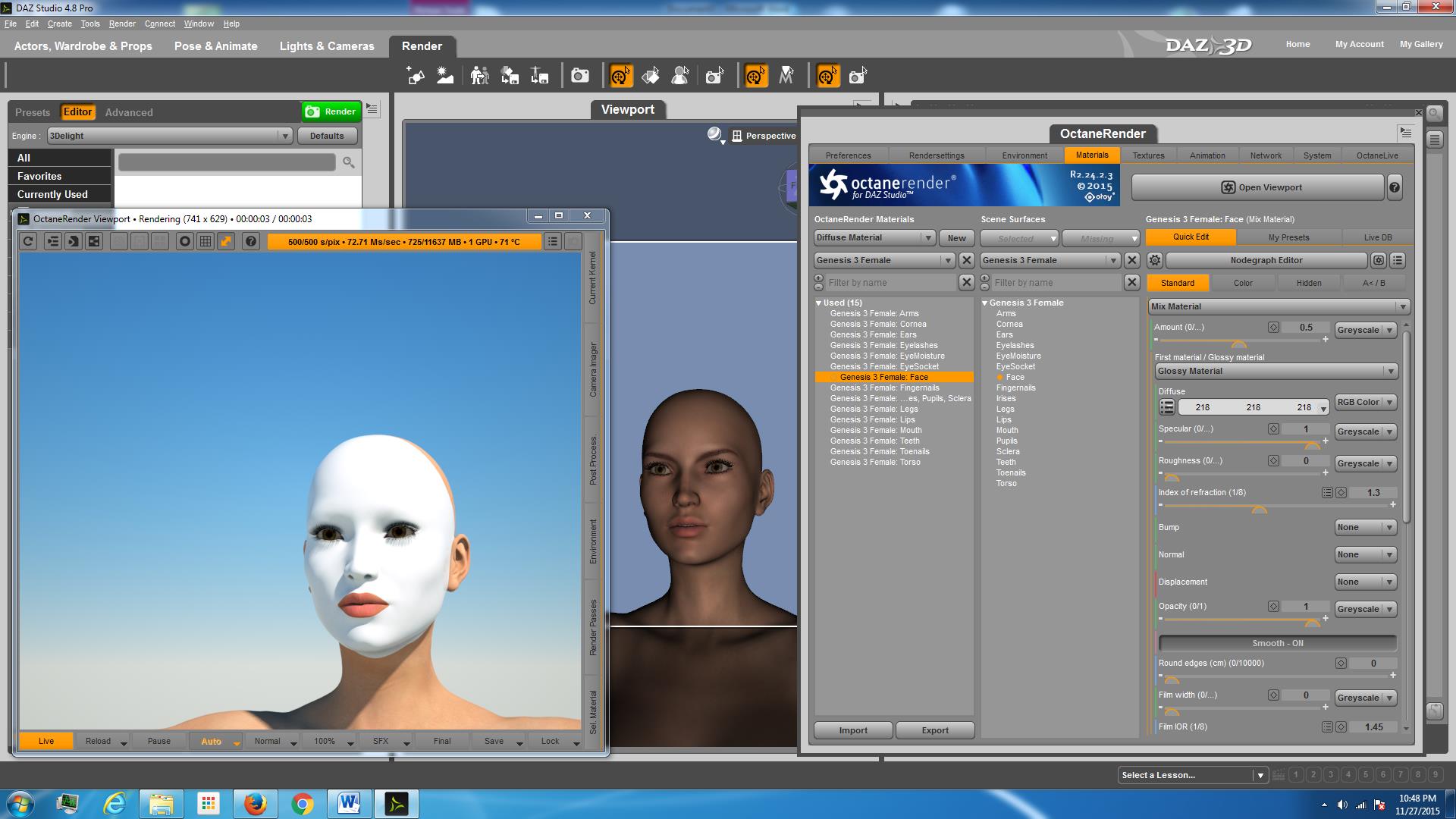

Paul, I reverse engineered the white texture issue.
I took G3F Adeline, whose Iray mats translate fine into OcDS by default as a single diffuse, and I changed that single 'Diffuse' in OcDS to 'Mixed Material'. It kicked out the maps and gave her the whitening.
'The Whitening' - Isn't it time YOU get tested?

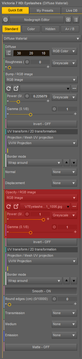

I cannot reproduce this error - eyelashes are converting to a Greyscale Image for me.
Just tested again - same results with the most recent version (2.24.2.3).
Instructions:
1.) Load any Genesis 3 based figure
2.) Apply the corresponding Iray materials
3.) Check the material tree for the material "Eyelashes"
4.) The Opacity map for the Eyelashes converts as an RGB image
Again: This only happens with Iray materials - 3Delight materials convert correctly.

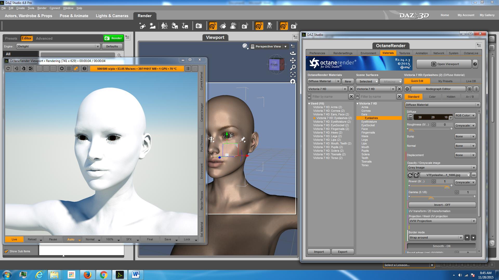

I can load Vic 7 HD straight up and apply no mats using "Victoria 7 HD.duf"/Actor, and I get this:
'Eyelashes' are Grey Image, 'Face' is single Diffuse with RGB Image loaded

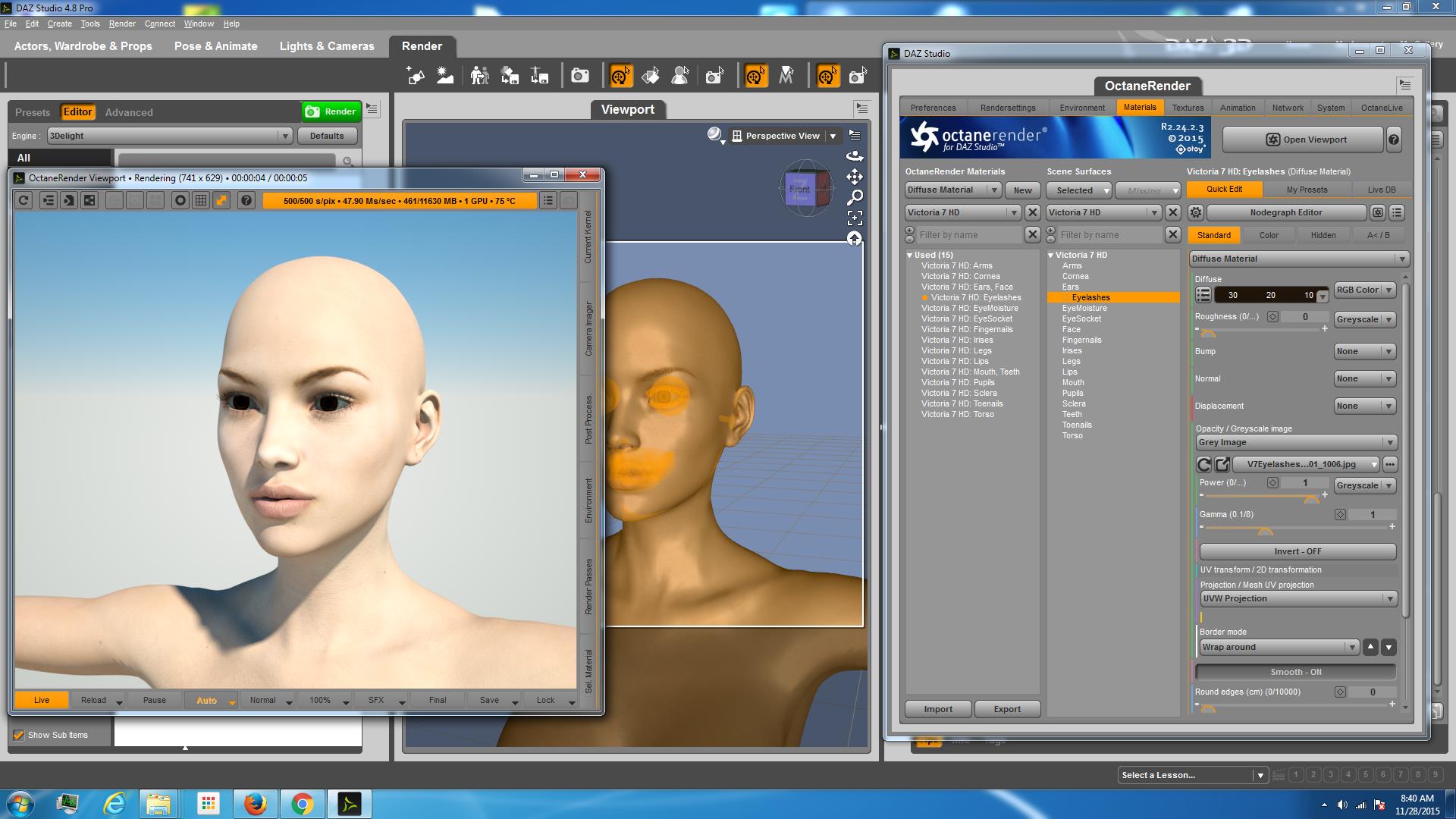

Then, if I actually go out of my way to apply the "Victoria 7 All MAT.duf"/Iray (H)Materials on top of the already loaded character, I get this...which is the current Iray mat issue we are coming across:
'Eyelashes' are Grey Image, 'Face' is Mixed Material with RGB Color of White and no image loaded
