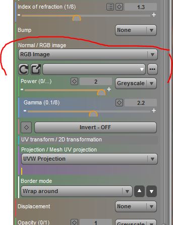

I found another promising thing which solves thie glitches now for me with some figures.
The "Normal" field of the second material.
It is set strangly to RGB Image, but the field to select an RGB Image is empty.
Also the Value of the Power slider for that is set the 2. The silder usually ends at 1.
Settings this Normal map to Nothing removes the glitches for me.

Normal maps are RGB images, so that's fine. As for the rest, it's quite possible that a blank normal set 'on' could cause a problem, as for the image being empty that just means there wasn't a normal map set in the Daz material, this might well be something that needs to be correct in the material conversion.
For props and sets/scenes normals are often used, for figures they're much rarer, Daz only started using them when Genesis 2 was released and not all of Daz figures do, as a general rule the more realistic figures have normal maps, while the toon ones don't, although there are exceptions, for example Ninive does, while the teen figures don't and very few PA/3rd party figures have them.
As for OcDS slider values, this is something that actually comes from Octane Standalone, the slider may only go up to 1, but they range values next to the slider name are the true min/max values you can set, in the case of Power (0/...) generally ... means 10 000 max, although there are cases were you can add a few more 0s.

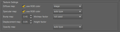

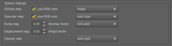

I sent t_3 a PM about adding the option to not automatically create displacement maps during the auto creation process. There is already a section in the plugin that lets you choose if it should creation diffuse/opacity etc maps, and it has a displacement power setting but you can't turn it off. t_3 thought it was a good idea to allow users to disable displacement, so I expect one day it will be added.
I agree with linvanchene , in particular
- create mix material: yes - no
For me, this and the displacement maps cause me the biggest issues right now.
Here are the texture options on the preferences tab. It already has some of the options we want, just needs a few more.
