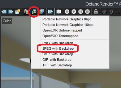

P.S. Sorry, one more request! Is it possible to add an option to save images as a JPG? It is in the animation dialogue, so I am guessing that it is possible, sometimes I prefer it for test renders and the images are smaller for posting online, keeping PNGs for the final renders.
Looks great PhilW. Thanks again Sighman I should get cracking on some testing of old projects that could use this hair upgrade.
Already supported my friend...PhilW wrote: P.S. Sorry, one more request! Is it possible to add an option to save images as a JPG? It is in the animation dialogue, so I am guessing that it is possible, sometimes I prefer it for test renders and the images are smaller for posting online, keeping PNGs for the final renders.
