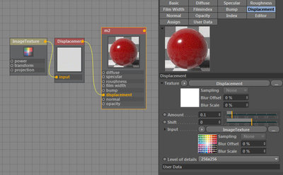

Hi there
Thanks for all your work Aoktar, loving Octanein C4D, just thought I would report three issues:
1) I can't load any kind of shader into the Displacement slot for any sort of material. Cinema hangs and then nothing happens. This is with new materials, old ones, everything! There is no crash so no bug report.
2) Not sure if it was Octane related but had a crash while adjusting materials so have attached the bug report for that.
3) Some weird things going on with the activation screen in the settings! Seems to work but I had to push 'deactivate' to make it activate?
All on OS X 10.9.5, Mac Pro, GTX Titan, CUDA 6.0.46, R14, plugin version 2.11.1 - RC1
Thanks!
Lindsay

Thanks for feedback.
1) you should check the attached image. Please ask if it would not be clear for you.
