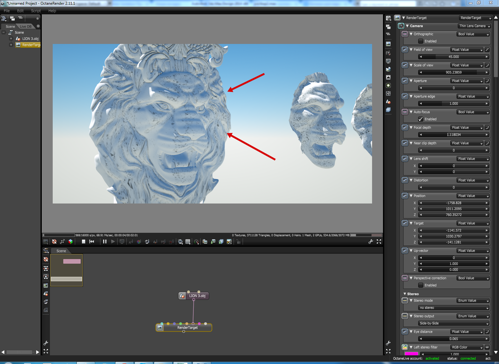

Elvissuperstar007
Posts: 2609
Location: Ukraine
bug obj export
2.11.1
