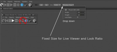

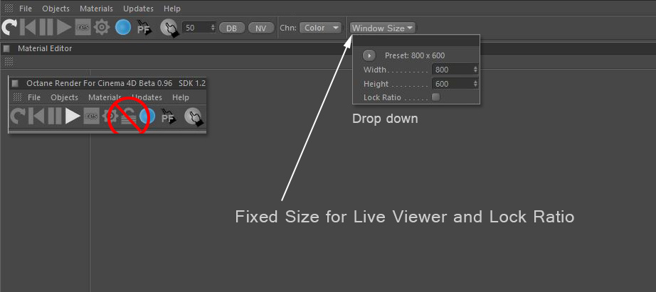

One thing that's always bugged me is the "Settings" toggle. It's either on or off, but white or grey don't really represent anything. What your plugin really needs is a drop down like "Color" has. This way you could lock the aspect ratio and even the exact pixel dimensions.
This would be a big improvement. Anyone else wish it had this?

ASyme1 wrote:Hi Aoktar-
Alec
I'm trying to stay away some gui operations because of complexity of usage c4d sdk.
you can render in same resolution of render settings if you activate lock resolution button. This button improved for immediately feedback. Does'nt this work for you?
Color combobox is for quick previews of some kernel modes.

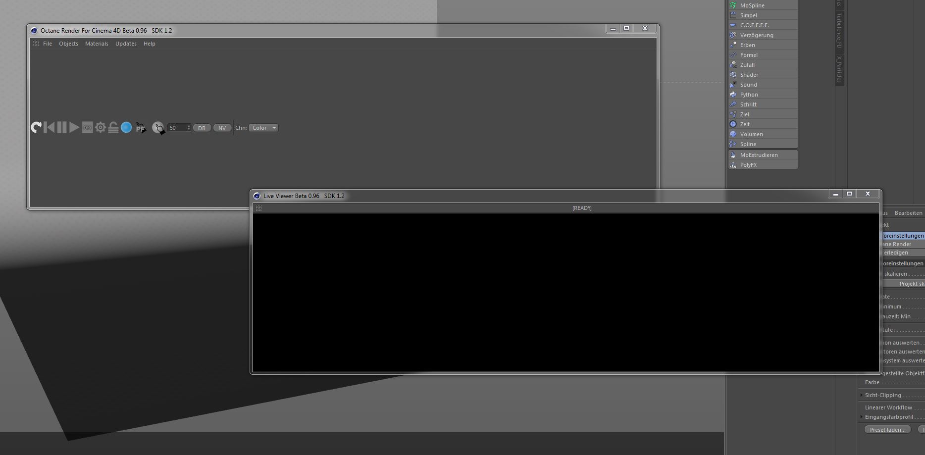

miohn wrote:Hi,
hmmm - trying 0.96 and it opens like this:
is that normal?
Installed es usual.
regards
Mike
yes, you can save to layouts. I'll try to change first sizes
