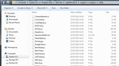

Hi Juanjo,
I seem to have a similar problem installing the plugin with LW11.6.x64
I see that the finger has been pointed at the Visual C++ SP1 x64 redistributable....whatever that is...As for uninstalling it etc, I'm really out of my depth here. Please can you hold my hand with this?

First try to install the plugin after install the VC++ 2010 SP1 x64 redistributable package:panphoto wrote:Hi Juanjo,
I see that the finger has been pointed at the Visual C++ SP1 x64 redistributable....whatever that is...As for uninstalling it etc, I'm really out of my depth here. Please can you hold my hand with this?![]()
David
http://www.microsoft.com/en-us/download ... x?id=13523
If you can't install the plugin after install the VC++ 2010 SP1 redistributable package, try this:
- Uninstall your Visual C++ SP1 x64 redistributable
- Download the attached .rar file
- Put the two .dll files available inside this .rar file inside your Lightwave(x64)/bin directory (this files are the libs needed by the plugin to load)
- Try to add the plugin again (of course the x64 plugin, and be sure that you have also the Octane.dll and Octane.dat x64 files in your Lightwave(x64)/bin directory)
-Juanjo

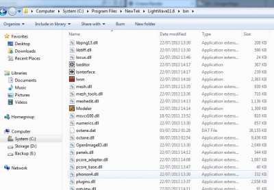

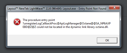

This is because you are mixing an old Octane.dll and Octane.dat files with current 1.20 plugin release.
Please be sure that the Octane.dll and Octane.dat files that you have in your Lightwave/bin folder are the files included in the last plugin 1.20 .rar file.
Octane.dll, Octane.dat and the plugin itself have to came from the same .rar file.
-Juanjo
-Juanjo

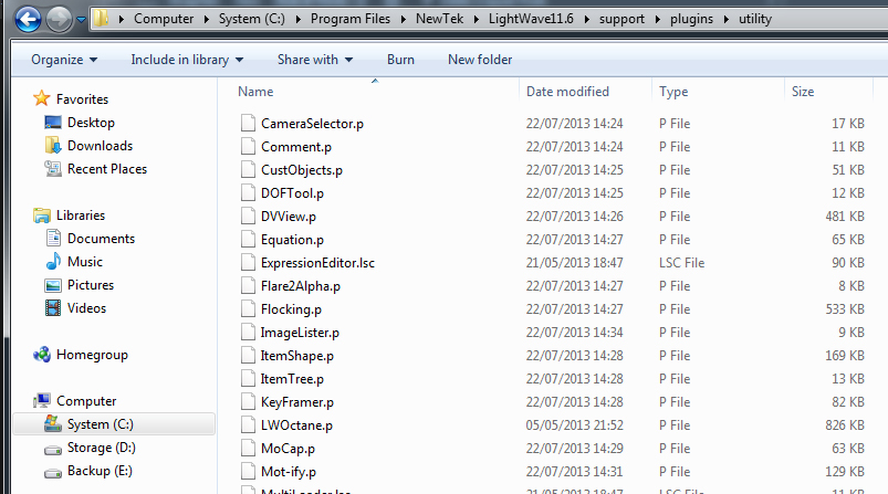

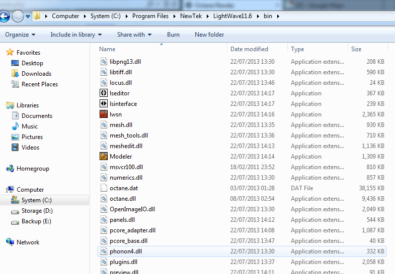

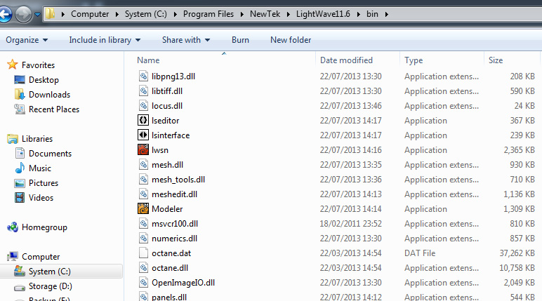

In a previous post I can see that you have a LWOctane.p file from May ... are you sure that you are using the last LWOctane.p?
Please download again the install .rar files:
http://render.otoy.com/customerdownload ... .1_x64.zip (for LW 11.5 x64)
http://render.otoy.com/customerdownload ... .2_x64.zip (for LW 11.6 x64)
And replace all your files (Octane.dll and Octane.dat in your Lightwave/bin folder, and the LWOctane.p plugin in your plugins folder) with the files inside the .rar file.
-Juanjo
