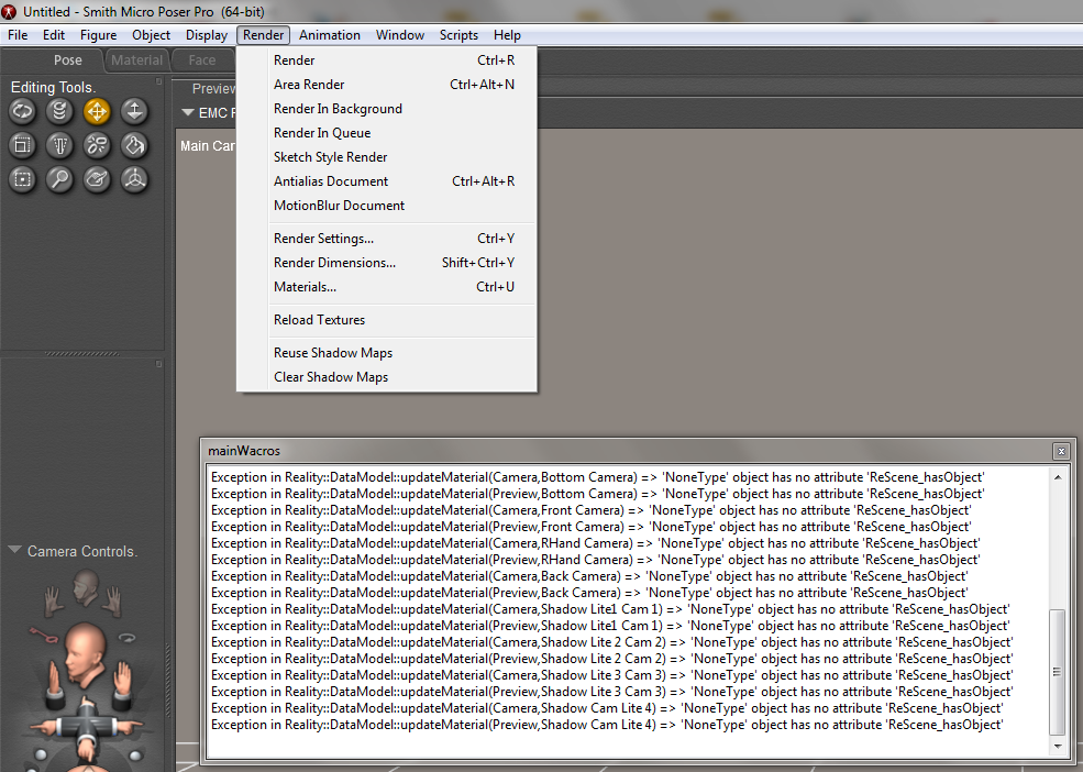

I'm also getting lots of trouble after updating the plug-in to 1.16a4.
I also have Reality installed.
Octane and Reality are both gone from the Render menu
Getting back the 1.14x version of the Octane plug-in made everything run fine again.

yes i have Reality installed. on poser 2012 only
but not on 2014,
but this issue. will not work on 2014,2012
i removed Reality from my system make sure that was not the problem
now get this error
TypeError: attribute of type 'bool' is not callable
