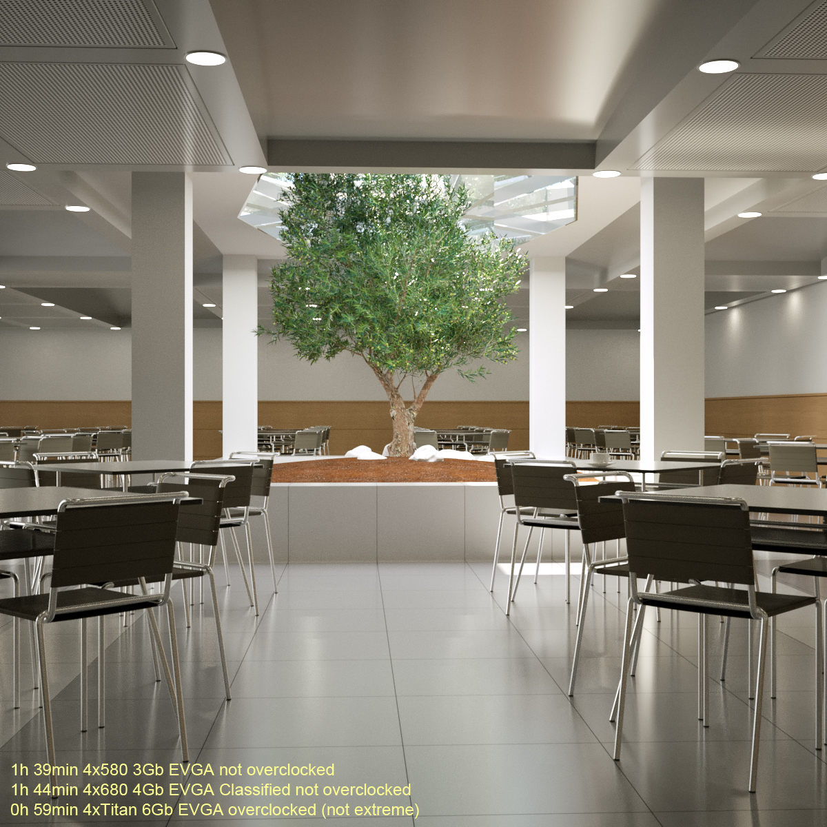

bug on mix materials with Titans

gabrielefx wrote:@Karba
How it looks like?
How it looks like?
I mixed two glossy materials, one white, the other one black. The mask was a single large dot (float image) to simulate a pattern of circular holes (dot black, background white).
see my latest post:
http://render.otoy.com/forum/download/f ... &mode=view
on the ceiling you see the right result rendered well with 1.11c (titans, 680s, 580s)
the 1.12 ignore the mask
quad Titan Kepler 6GB + quad Titan X Pascal 12GB + quad GTX1080 8GB + dual GTX1080Ti 11GB

Karba wrote:
So This is incorrect result?
Could you show right one?
this is the correct one
the incorrect is without those tiny holes
