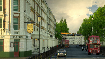

I am currently adding a cloudy sky in my city scene, and a material not casting shadow would be very useful. Currently, a sky mapped on a plane, a cylinder or a sphere blocks the lighting coming from the daylight system.
I play with the transparency of the mapped environment, but it also acts on the brightness of the scene (it darkens it a lot) and it is very difficult to equilibrate the light strength using sky transparency value, the transmission value (image usable too), sky image gamma and Daylight Environment Power.
The nice thing is that currently the clouds take advantage of the color of the sun, but this could be corrected by controling the Power value of the image with RGB sliders, or by editing the sky image itself before loading it in Octane.

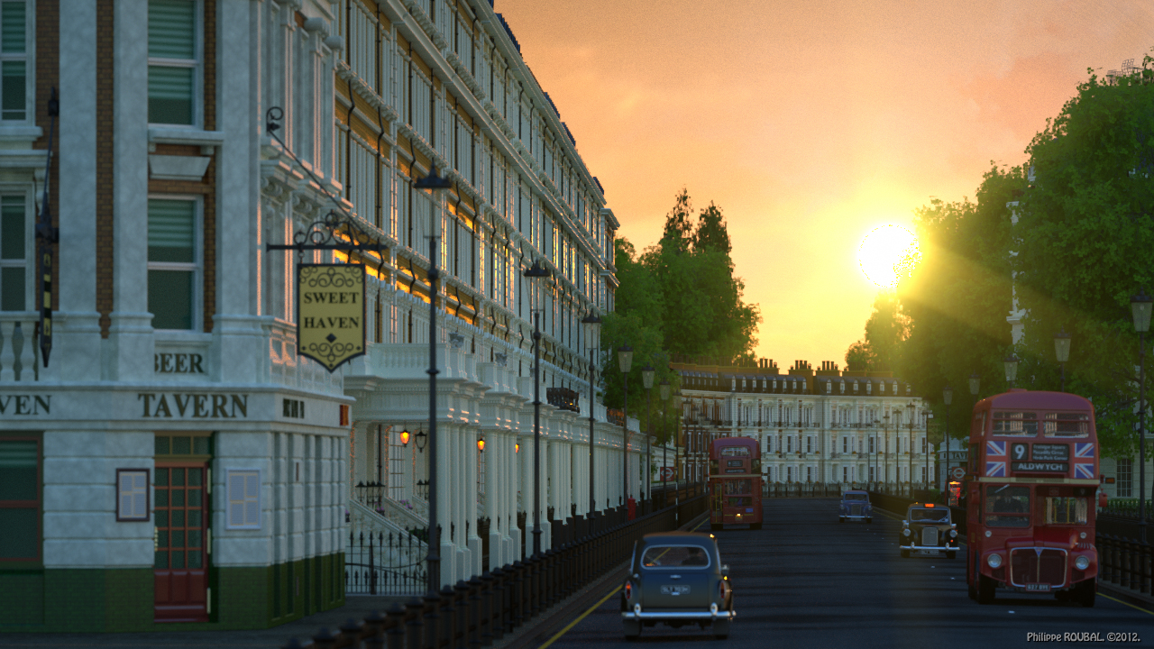

To illustrate this, in the image attached, the actual average tint of the sky image (mapped onto a plane) is grey and blue, as shown on the second image made with different North offset and hour settings.
In this example, the sky is just a plane, so it is not totally blocking when the sun is in the opposite direction, but with an environment mapped onto a shere, the scene would be pitch black with no transparency. With transparency, the environment lighting passes through, but under an alpha of 0.8 (like in first image), the sky texture becomes very few visible.

Roubal: Have you tried to create an opacity map of your cloudy sky? I mean, you could try to generate a map that will apply much less opacity to your clouds and at the same time make the rest of the sky be almost transparent. So you could illuminate your scene with the new daylight sytem, blocked by some clouds, and these clouds would throw shadows into your model at the same time.
Just an idea, I don´t know if anyone has tried it before.

@JulioCayetano : Your indea is interesting. So far ,I have used the image of the sky for transmission, but not for opacity. I will follow your advice and try to make a more contrasted greyscale image to be used as an opacity map.
I will post the result if I get something good with this method.
