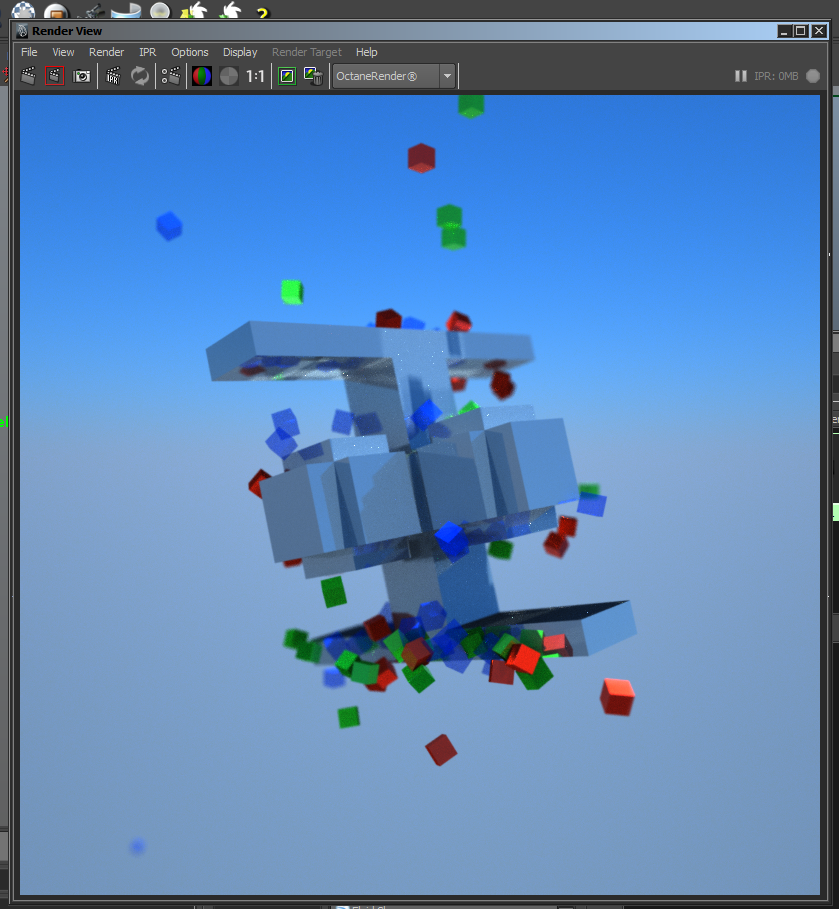

It is also possible to override all this shading behavior by assigning another shader to the particles, like in Jimstar's picture. Then the particles will still read PP attributes of the particleshape, but the shading will be overriden by the new shader (so no PP shading).

No problem to get the rgbPP for every particle when loading the scene to Octane engine.
The problem is: Octane engine does not have the means to deliver distinct colors to a couple of objects that use the same material... So, if you have only one Octane material node connected to the particle, only this material node will be loaded (and reloaded in IPR) to engine. Otherwise there will be a situation when a million of Octane material nodes will be generated, one for each particle when loading the scene, and when reloading the scene, etc... The huge impact on memory...
And in addition, Octane materials have a lot more settings than just "diffuse color"...
I think in this case, the method TBFX wrote about (one base object for each material variant) is more effective and more flexible, as you can change not only "color" but any settings of any Octane material type for each particle variant...

I think I've found the way how to get the sterling pseudo-random Octane shading on the particles without using this rgbPP... With the full set of each material attributes adjustable...
Working on it...
JimStar
Posts: 3852
OK, my way works...;)
