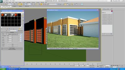

MaTtY631990, thank you for response, is the same result, i can't see the texture applied into my objects, i'm used 3ds max 2011 x64 bits, into windows xp x64
maybe the octanerender team have the solution
Can't you see it on render view, or just in 3dsmax viewport?merid888 wrote:MaTtY631990, thank you for response, is the same result, i can't see the texture applied into my objects, i'm used 3ds max 2011 x64 bits, into windows xp x64
