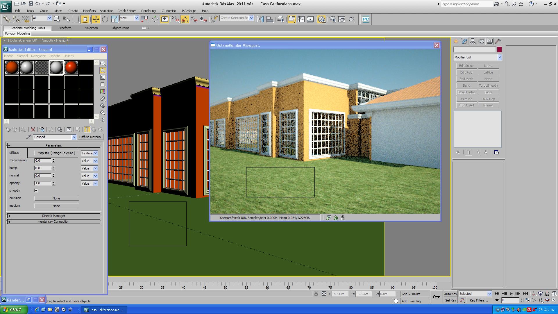

MaTtY631990, thank you for response, is the same result, i can't see the texture applied into my objects, i'm used 3ds max 2011 x64 bits, into windows xp x64
maybe the octanerender team have the solution
Karba
Posts: 2300
merid888 wrote:MaTtY631990, thank you for response, is the same result, i can't see the texture applied into my objects, i'm used 3ds max 2011 x64 bits, into windows xp x64
Can't you see it on render view, or just in 3dsmax viewport?
User avatar (Default)
merid888
hi, i can see in the viewport octanerender but not into the objects applies i add image
texture grass
texture grass
