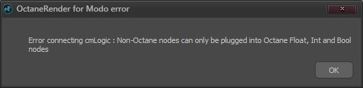

Hi Paul, I'm still getting this dialog box when I open a scene created with a previous octane plugin build:
Trouble is I can't easily identify the offending node trees and I remember you said something about this being rectified in later builds. Is this on it's way anytime soon?
Cheers,
Dino.
