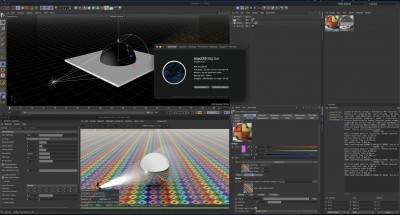

I can make it happen each time i add an octane material. doesn't matter if its from the DB or just extensions octane material.. menu..
Eventhough i have disabled Intel graphics in octane prefs.. BTW Mine don't stay disabled after a reboot... !!!@!!
I noted that when i got the beachball freeze.. it was doing a render failed! intel card was the 3rd one.. So i am wondering if the material thumbnail is trying to use the intel card when it should NOT..!
See logs attached.. and screen grabs!
This happens 100% of the time.

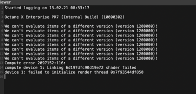

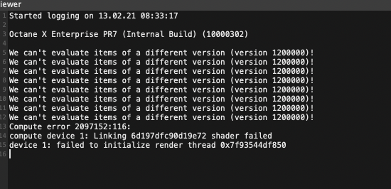

Well it still seems to beachball when making a material. - and then locks up c4d till i force quit it.
Can't even get to the point of starting the ipr..
i did get a 2nd message i didn't see before.. and i DID remove the Redshift plugin as requested to test..
Not much of a difference though...
