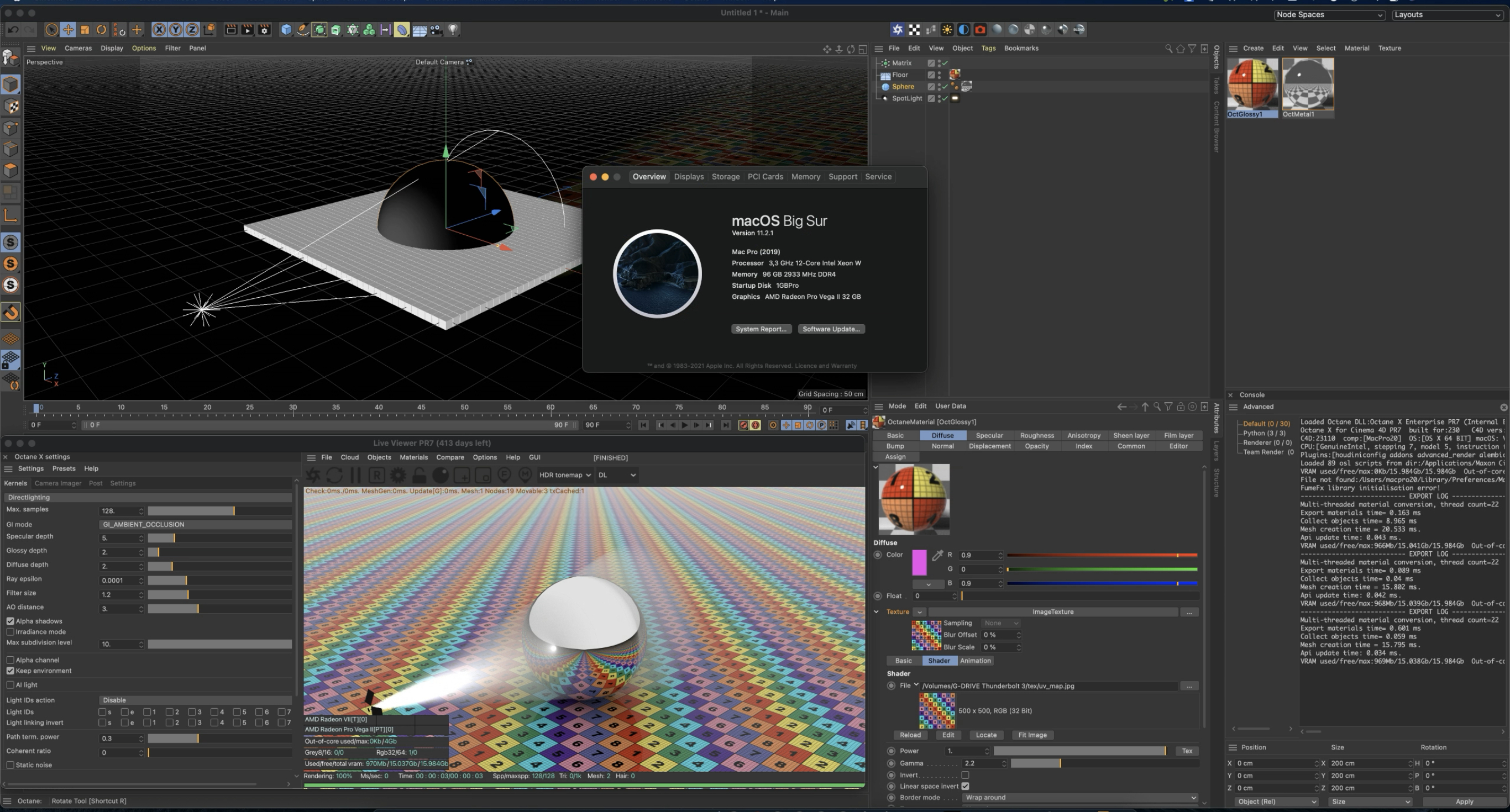

I can make it happen each time i add an octane material. doesn't matter if its from the DB or just extensions octane material.. menu..
Eventhough i have disabled Intel graphics in octane prefs.. BTW Mine don't stay disabled after a reboot... !!!@!!
I noted that when i got the beachball freeze.. it was doing a render failed! intel card was the 3rd one.. So i am wondering if the material thumbnail is trying to use the intel card when it should NOT..!
See logs attached.. and screen grabs!
This happens 100% of the time.
