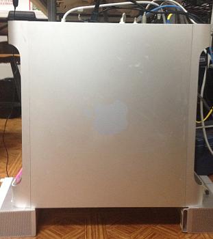

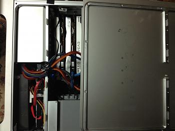

No strange score result there. Most likely, no score error at all. I've got five of those GTX 580s (in the 3G Classified version with 2x8-pins plus a 6-pin) and am not currently considering selling any of them (paid about $200 a piece for each of them two years ago). Pics below are of one of them performing in my old 2007 MacPro2,1, yielding 11.90 (PT) and 25.11 (DL). The other 4 are in a single Windows system and they perform almost exactly four times better, yielding about 101+1 (DL) and 48+1 (PT).

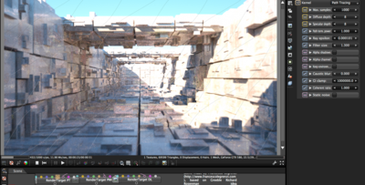

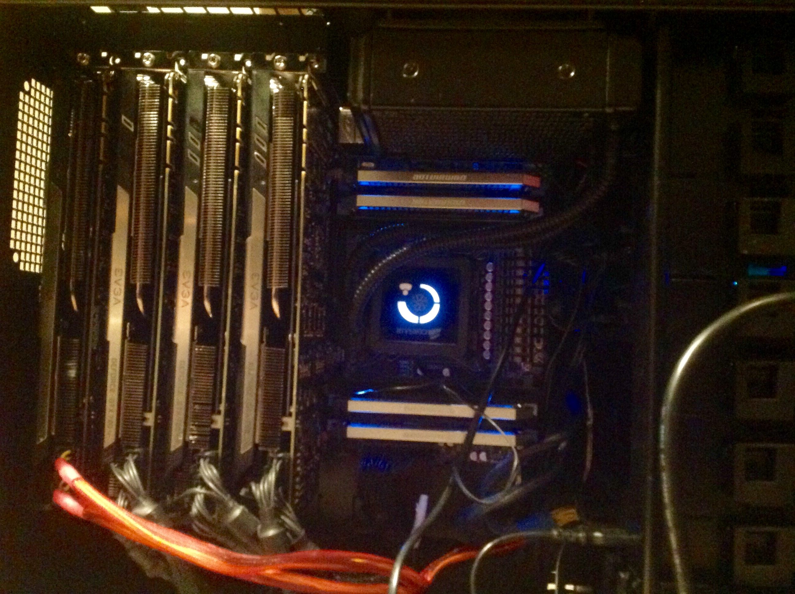

4 x GTX 780Ti SC ACX OC on Air
Pathtracing
Pathterm=1
Coherent Ratio=1
~80.22 Ms/s
Directlighting
Pathterm=1
Coherent Ratio=1
~250.63 Ms/s

Great scores. What is a distance between cards? Did you use raisers?

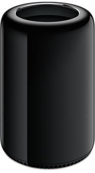

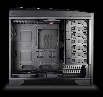

Those four GPUs are right next to each other on a Gigabyte UP4 motherboard (without any raisers) mounted in a SilverStone Raven 3 [ rv03b ] case. The thermals are better controlled because of how the motherboard, and thus the GPUs, is/are oriented, with the heat exhausted straight up out the top of the case. The GPUs hang vertically and resemble bats hanging upside down from the roof of a cave. Thermally, with the help of two large diameter stock fans seated at the bottom of the case and drawing in air from floor level, heat just rises straight up out of the top of the case, rather than from out of the back of the case like most GPU- atop- GPU-on-air builds. Moreover, the heat from one GPU doesn't have as great of an heat effect on its neighboring GPU, although the inner two GPUs are generally a degree (F) or two warmer than their outside neighboring GPUs. Doesn't this thermal design also mimic the 2013 MacPro cylinder and nature (cooler air is lower than warmer air) ? I like it so much that I've flipped most of my other systems, lowering the GPU temps by 5 to 10 degrees (F) by orienting their fans to pull air up from the floors (I know - keep them clean) and by thus orienting their GPUs to blow warmer air more easily out of the back (now the top) of their cases, such as my 2007 MacPros that I've outfitted each with 3 GPUs. I haven't flipped my lid, have I?

The vertical setup with extra fans at the bottom does great job. The temperature scores are so good, especially that you set core clocks so high on air. If you want to keep them clean there are custom demciflex filters.
Is it loud at 3122 RPM?
