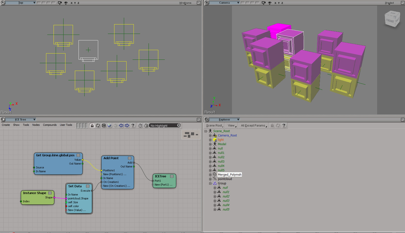

Should be simple for single meshes.
Create nulls where the instances should be. Move all nulls in a group and use this group as source for a AddPoint in a IceTree.
For models with some meshes, it doesn´t work.
The solution is to select all meshes in the model and create a new mesh with Create->Poly.Mesh->Merge.
Don´t forget to merge the materials & uv´s.
This merged mesh you can now use as an instance shape in a IceTree.
Hope this helps.
