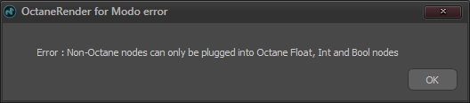

Thanks Paul. I just loaded a scene im working on now to check and a couple things immediately cropped up. When I go to render , I get this message:

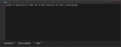

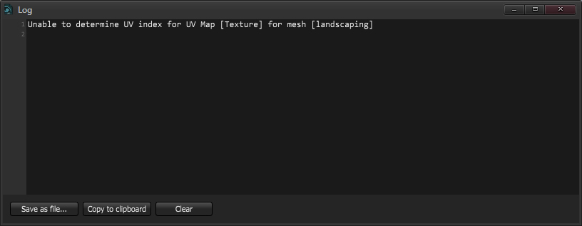

And this one:
Neither showed up before when I was using this version of the plugin "OctaneRender_for_Modo901_2_25_0_99_64bit" and I'm having trouble making them both disappear.
Hi Dino - that message means you have connected a modo schematic node to an Octane node like a material, emission, etc. If you are connecting modo nodes to Octane nodes - it needs to go via an Octane Float, Int or Bool node. I will put together a quick video explaining how this is done.
And this one:
That message means there were multiple UV vertex maps for the background mesh and the plugin couldn't match them with the other meshes. The video at https://docs.otoy.com/#42Using%20Multiple%20UV%20Maps explains how to address this.
