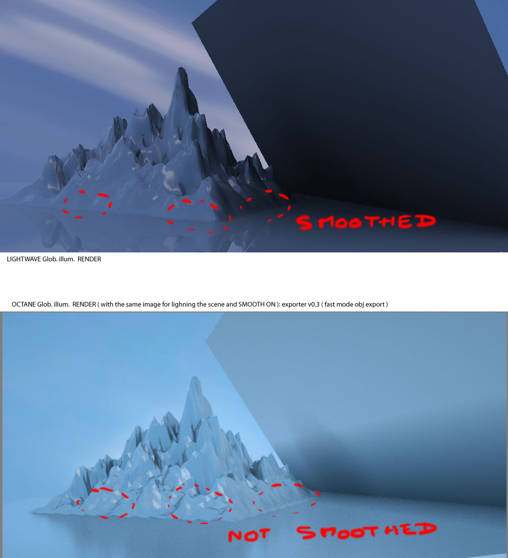

galford: as explained to us Face, i'm afraid the 'terminator' effect is due to the octane GI method and not to the LW exporter.
For the LW normal/smooth problem export, i join this picture and a packed scene with objects and image for Global illum. ( done with LIGHTWAVE 10.1 ) and rendered with octane export 0.3 ( fast mode OBJ export-> the 0.4 and the normal mode OBJ export give more problems)...

vipvip wrote:galford: as explained to us Face, i'm afraid the 'terminator' effect is due to the octane GI method and not to the LW exporter.
But is it the case with maya, XSI, etc...??
Can somebody, from other software, answer us ?
What do you think about that Radiance ?
Regards,
Franck.
vipvip
Posts: 726
Joined: Fri Apr 22, 2011 9:28 am
It's work with blender and maya too, and il the same problem, you have to subdivide meshes to obtain perfect result ( i hope RS team will resolve this because it's great to work with low res geometries)...
