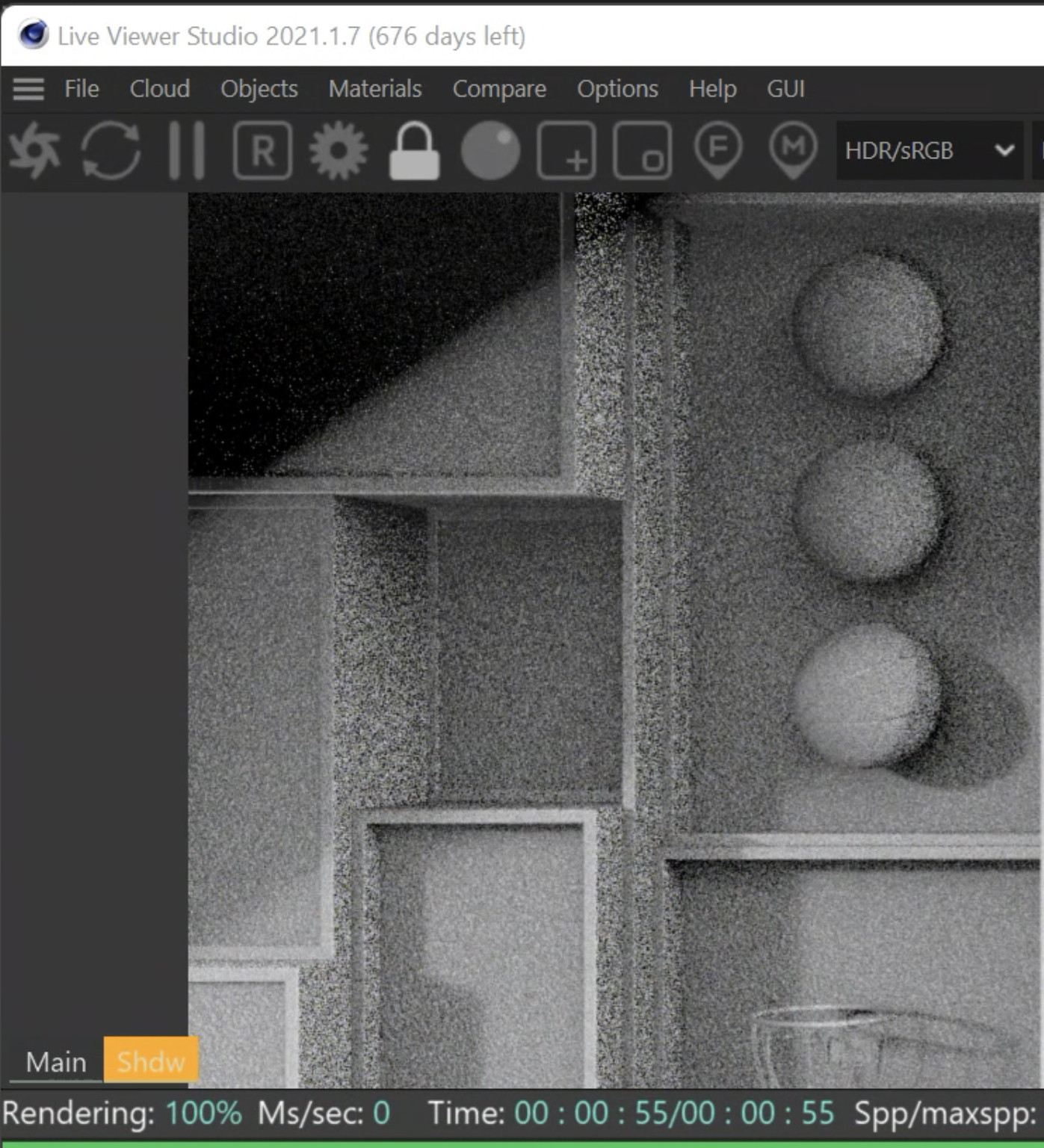

KeeWe wrote:Same here, plugin R3 won't load. edit: c4d version: 2023.1.3

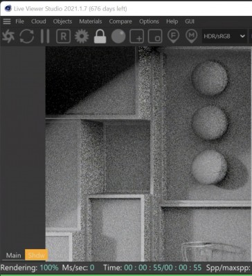

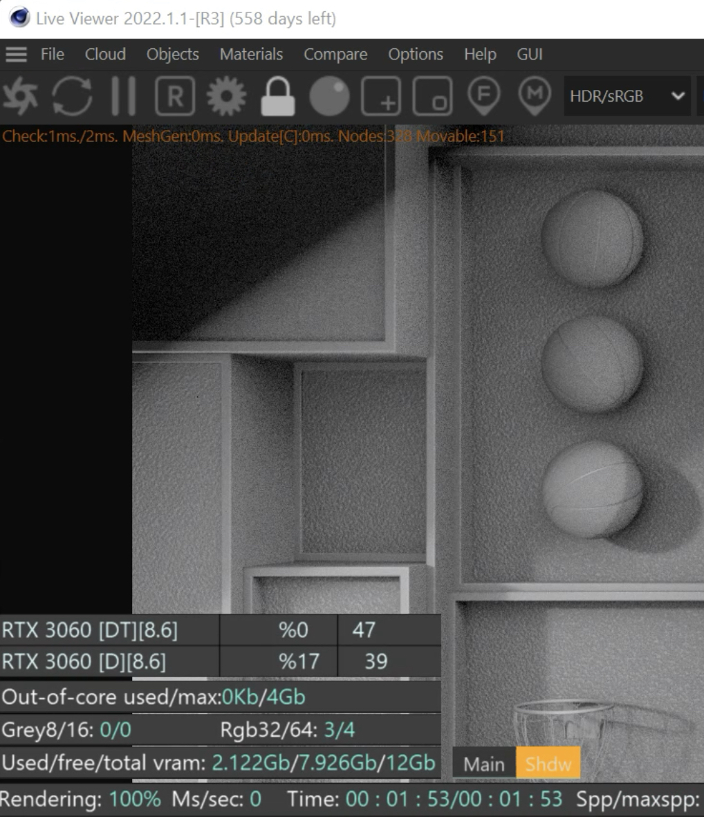

I ask again: is the shadow pass bug supposed to be fixed in this plugin rev? Main app SDK seems to have it fixed (according to the changelog). I get a little bit worried since we are approaching a deadling and can't use (but need) the shadow pass in Post.
Yes, Shadow pass with HDRI has been fixed:
2021.1.7
2021.1.7
2022.1.1-R3
2022.1.1-R3

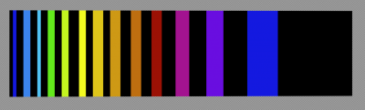

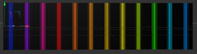

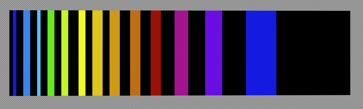

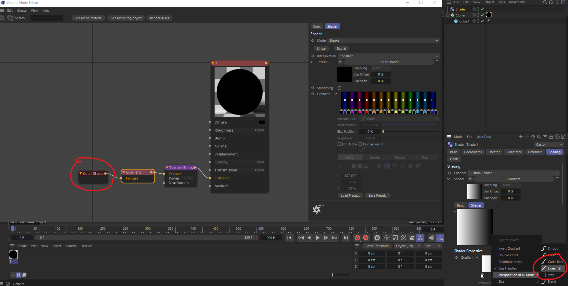

Happy to say the bug I mentioned before has been fixed, but I've found a new bug with how octane maps the shader color values to the color shader node in materials.
Usually to color a set of clones using a gradient in octane, I put a black and white gradient in the shader, set it to linear so the colors are mapped evenly, then apply the material to the clones.
Simple instance color setup

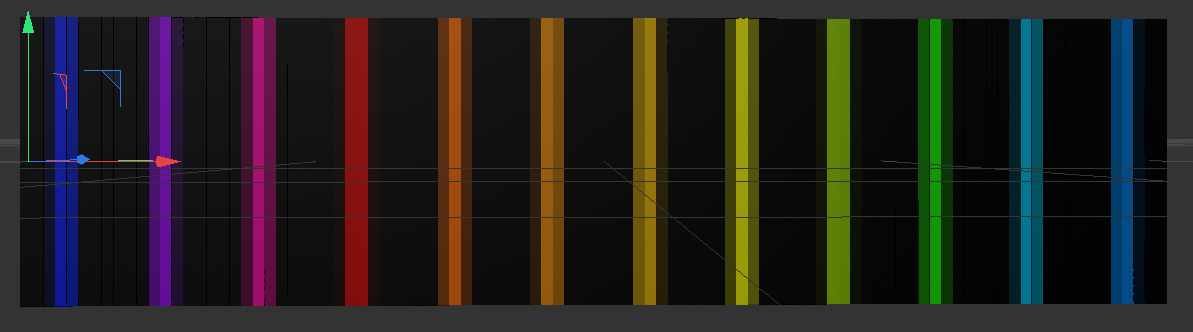

In the render, my gradient is supposed to be linearly applied along the clones:
How it's supposed to look
However, now Octane maps them in a cubic or non-linear way, like this:
Current Octane Result
Posts: 16068
Location: Türkiye
UON.Visuals wrote:Happy to say the bug I mentioned before has been fixed, but I've found a new bug with how octane maps the shader color values to the color shader node in materials.
1-How you can define something like bug? You do something complex and also there are a lot of limitations that avoids to do exact same gradient.
2-Why don't you share a scene, I cannot create same scene.

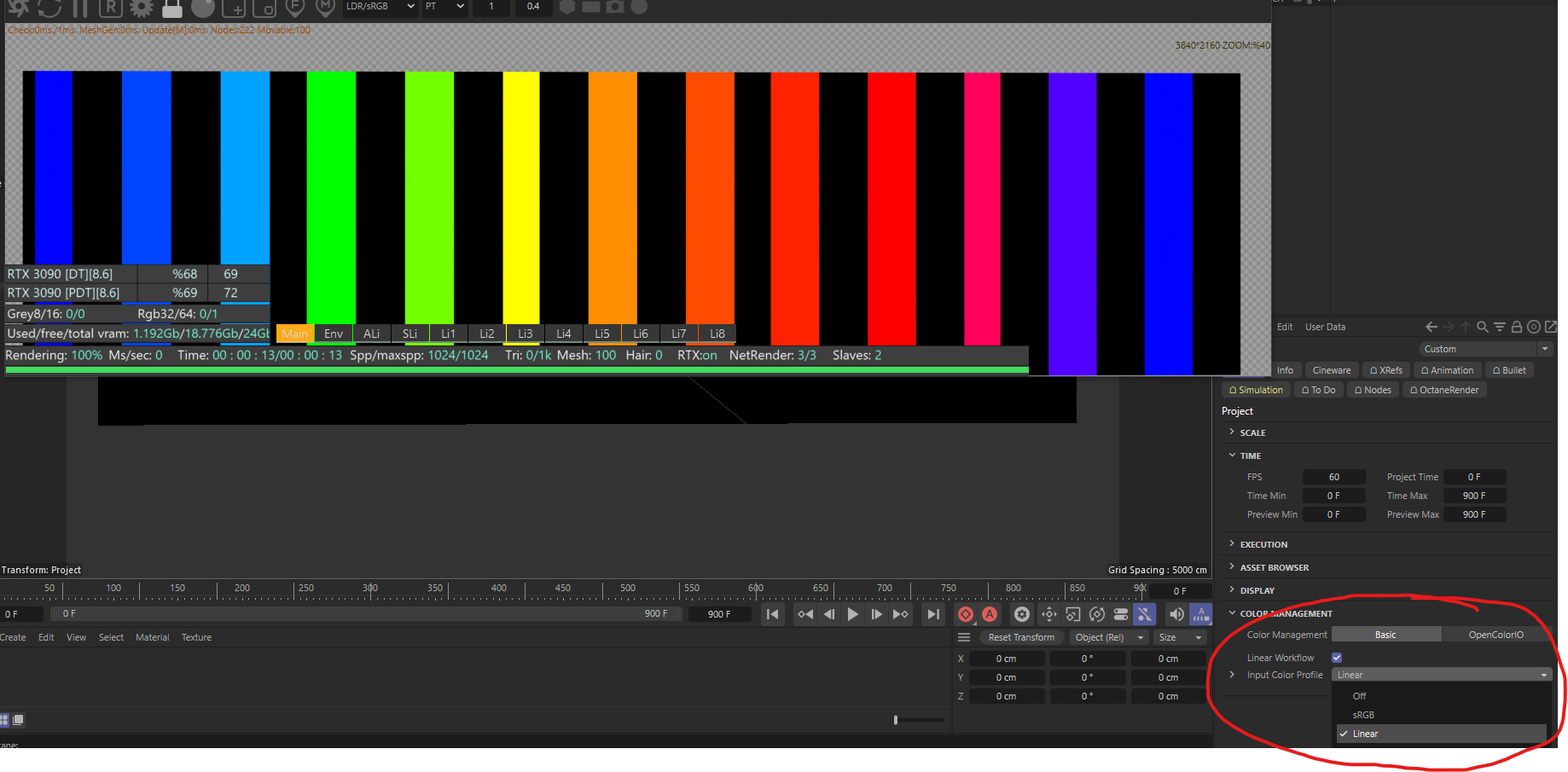

UON.Visuals wrote: However, now Octane maps them in a cubic or non-linear way, like this:
Check if you have OCIO color space turned on in C4D. I noticed that gradients have issue using OCIO color space.
Architectural Visualizations http://www.archviz-4d.studio

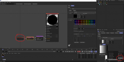

UON.Visuals
Posts: 29
Joined: Mon Sep 05, 2016 12:28 am
Thanks, that was exactly the problem! Had to also switch from sRGB to linear in the basic color management mode
