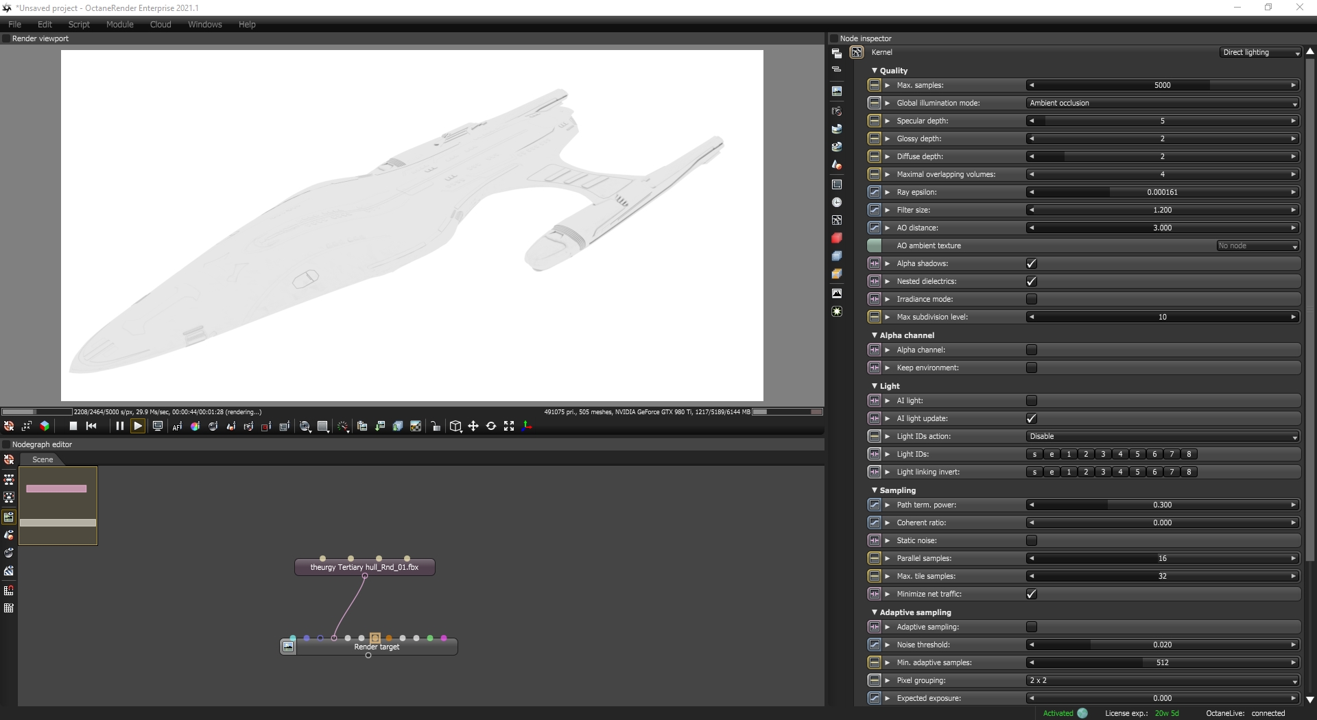

Hello, I have a problem in this version importing fbx exported from c4d.
in 2021 opens correctly and its normals are correct, respecting phong and breaks
2022 is scrambled or load incorrectly
If I save 2021 version and open it in 2022 it loads correctly
Loaded fbx in octane 2021 works good
Same fbx in octane 2022 normals are bad
Ray epsilon is adjusted according to display the model scale
As a side note can I have a reload green button on fbx and alembic loader like is when importing obj?, although I can't overwrite alembic files while they are in use on octane. also vertex colors loading from fbx will be awesome too, setting up alembic from c4d is a pain as it don't convert material assignments to polygon selections on export.
Thanks.

omardex wrote:Hello, I have a problem in this version importing fbx exported from c4d.
Can you attach (or PM me) a sample FBX file that produces this problem please?
