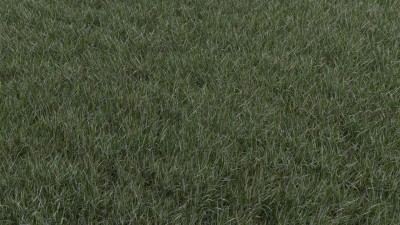

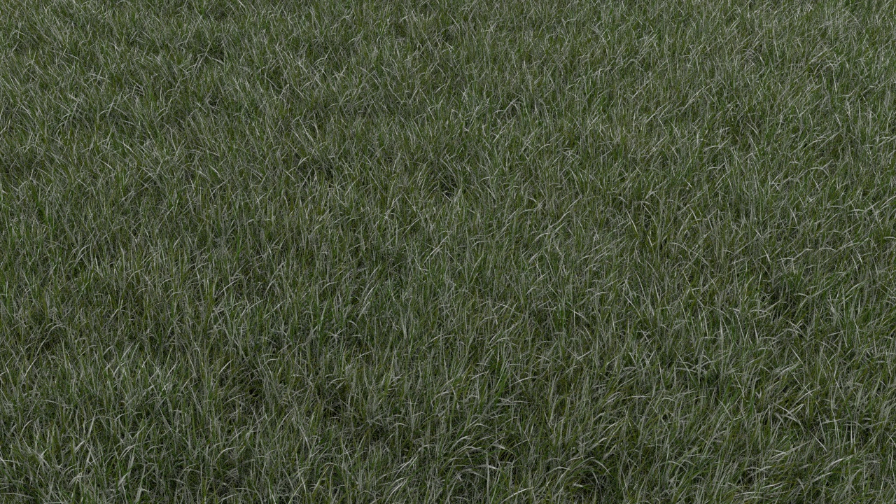

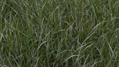

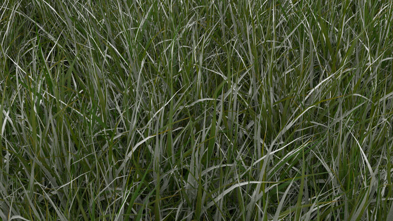

I'll be checking again in SA topic if I find any clued about these differences in reflections, while I'm attaching here a sample scene with grass to see what I mean about transmission. I attach even a couple of screenshots, so will be more clear.
Regarding last question, yes, I was meaning what it happens opening scenes made with 2020. Texture color space not always is linear sRGB, and I double checked and changed where I saw that results were different than before...

@shine,
I think you need to change "transmission type" to "diffuse". It's set to specular for now.
