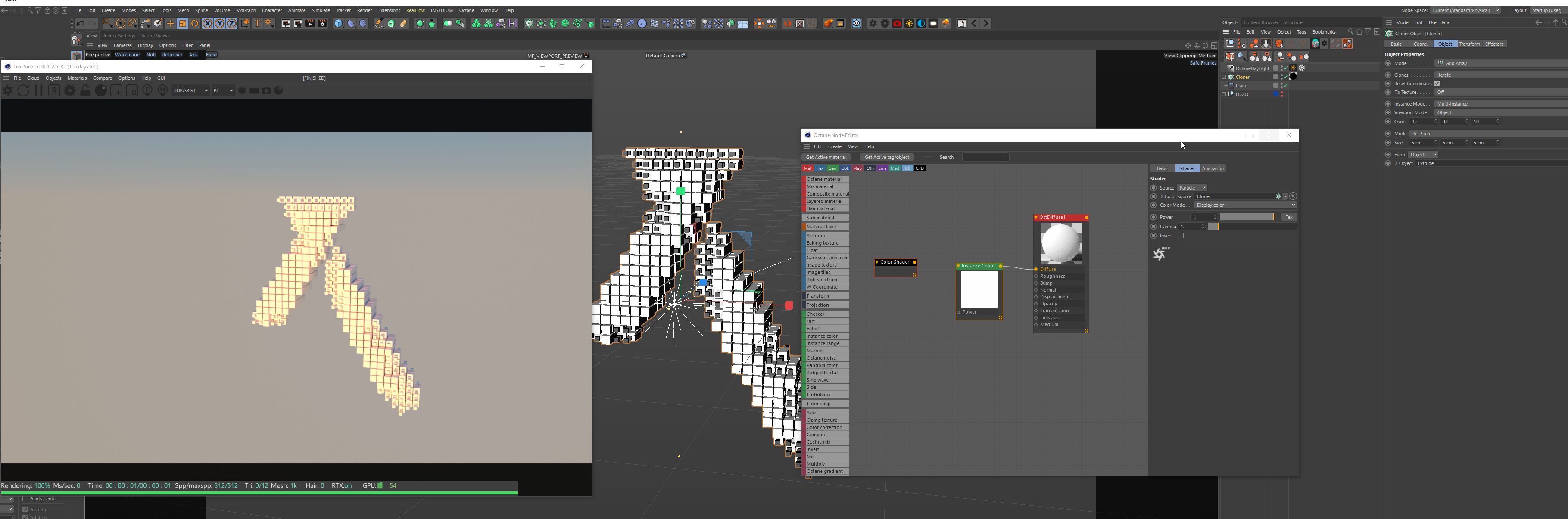

I try cloner set to multi instance. I add an effector with color. I use instance color/particle and I add cloner and its not working.
Maybe something with my fields? Im using an object in the fields with point distance. I ll try again if u say its working on ur end and report back. Thanks

Yes it does not work re checked. Attaching scene file.

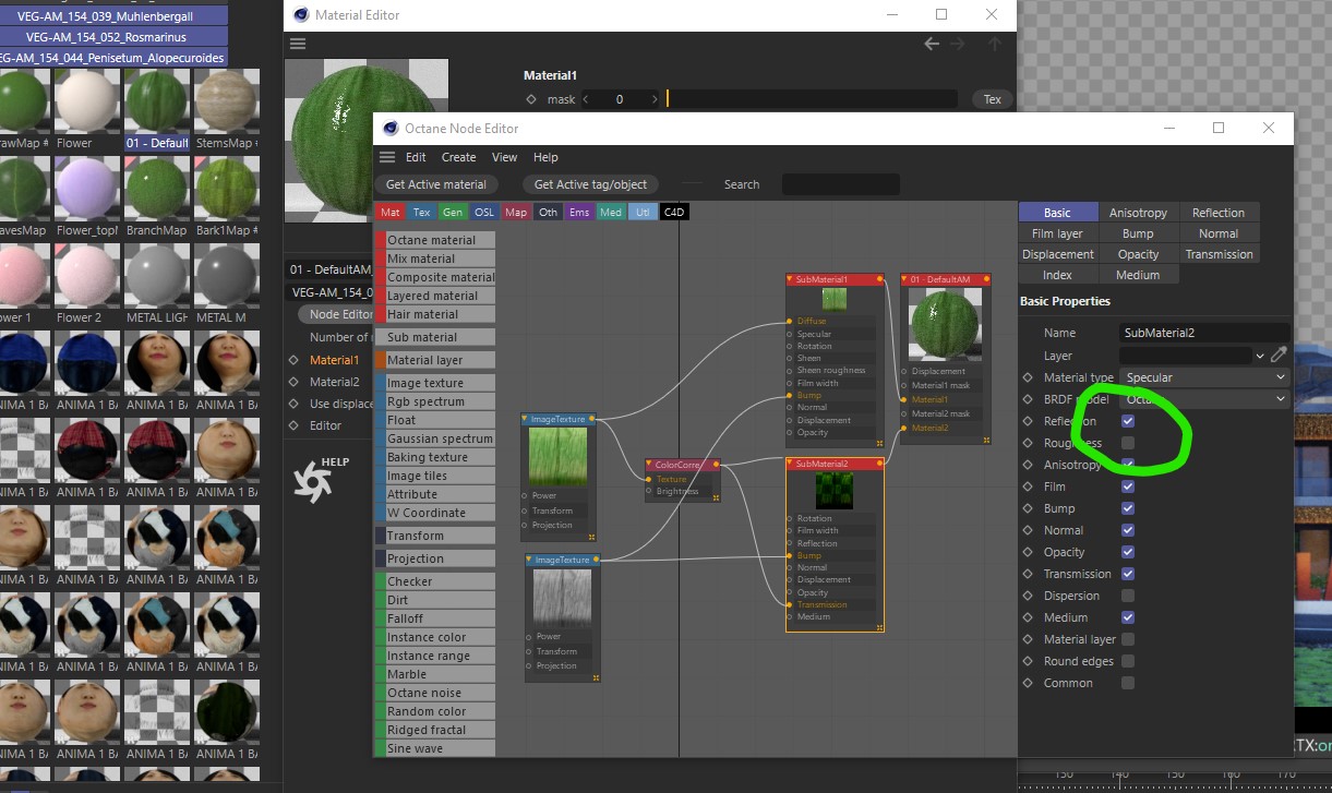

New behavior I have just noticed: old assets with Blend shaders requiere "roughness parameter" to be reactivated. This can be inconvenient if you deal with over 100 assets in a scene.
Regards,

thanulee wrote:Yes it does not work re checked. Attaching scene file.
https://www.dropbox.com/s/2ozhy39d8bn2v ... 5.c4d?dl=0
Not sure what you did but it's not working standard material+standard renderer too
Haha I broke it big time :)
Well it might be related to having as a field, the same object that I am cloning onto. It shouldnt interfere with anything though, but maybe its that?

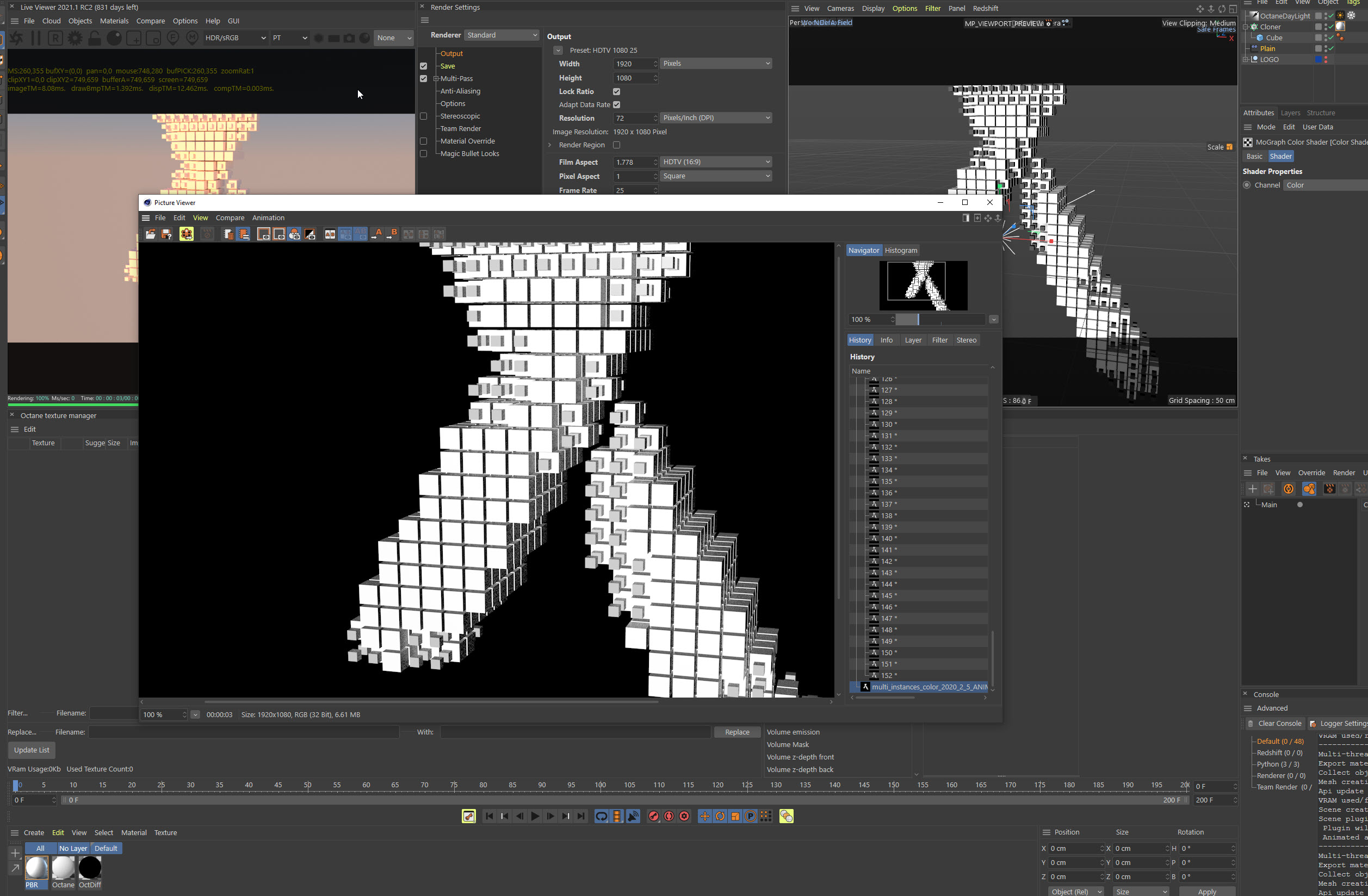

Thanks you for this version,
With 2020.2-r5 I have a problem with multiple vdb.
When 2 vdb are cross I see the volume cage.
It's normal ?
Thanks you

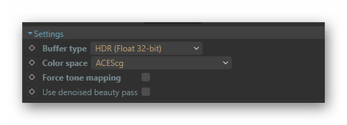

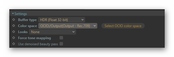

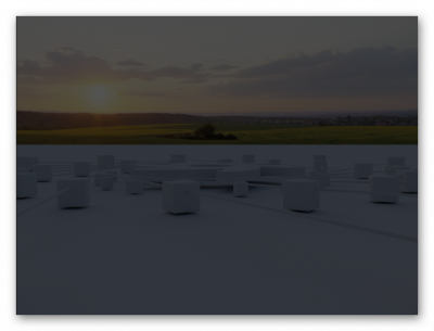

Possible bug :
Exporting to 32bit linear EXR while using OCIO like Filmic ( https://sobotka.github.io/filmic-blender ) generate 8 bit color depth file - not 32bit HDR. While exporting as ACES works fine.

SSmolak wrote:Possible bug :
Which format and from where? EXR or Octane-Exr? LV or PV?

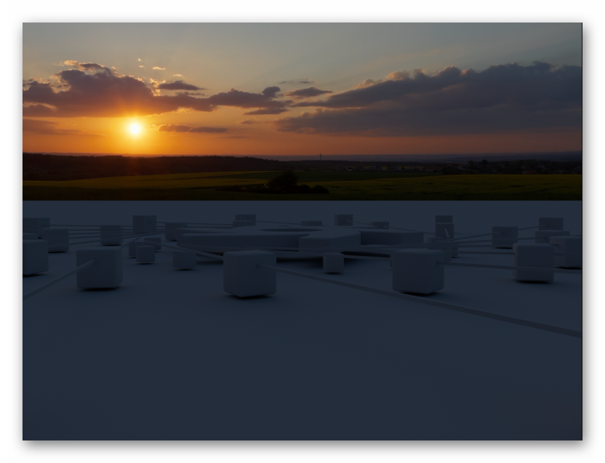

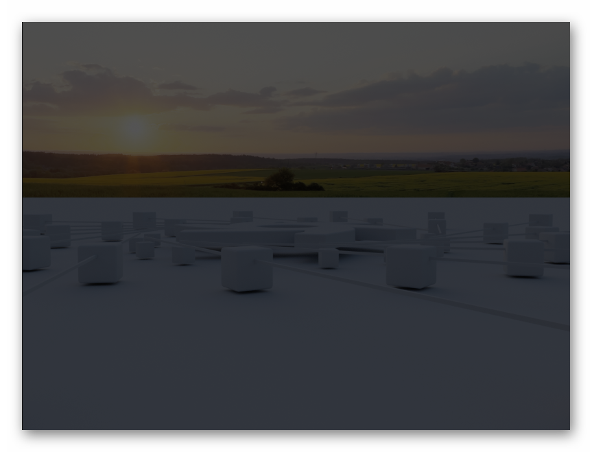

From PV. If color space is set to main ACES it works fine - full 32bit output but if color space is chosen from OCIO list it saving as 8bit.
Images are after 32bit exposure correction in external software.
ACES:
Screen_czwartek, 23 września 2021_12h44m01s_002_.png (10.79 KiB) Viewed 5834 times
OCIO:

SSmolak wrote:
This is not directly related to plugin part. Also not sure it's a bug in Octane core. Even not sure it's a bug or not. Maybe about the profile you choose in OCIO. Best answer will come from @Karl.
