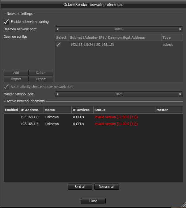

Hello Aoktar.
Thank you again for an wesome and quick release!
I would like to report a bug, regarding network rendering. When i try to find the other nodes through the C4D plugin it gives me an error that the nodes have the wrong version ( see pic). That is wrong though, because they have the right version and they show green in the standalone version of Octane.
Thank you in advance for your time!
Konstantinos D
