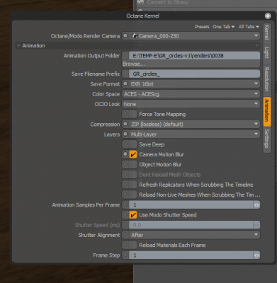

Does Render animation work with new 177 build? Mine saves the first file only, then renders but doesn't save all other frames.
It works (same scene, same settings) rolling back to build 176.
Attached is a screenshot of my render setting.

GOTHACOM wrote:Does Render animation work with new 177 build? Mine saves the first file only, then renders but doesn't save all other frames.
G
I will release a new version which fixes this issue in the next 12 hours.

I have updated the installers at the top of this thread with:
2021.1.0.178
- Fixed issue introduced in 2021.1.0.177 where multi-layer EXR files were not saving correctly when rendering animations
Paul
