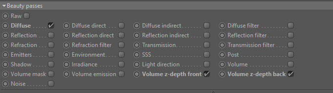

@VitaliyHavrylyuk
They will not be seen on z-depth. Have special passes for these. See picture.

aoktar wrote:@VitaliyHavrylyuk
I'm aware of the Volume z-depth passes, but they always seem to create very rough edges close to the alpha edges (see example below). This is not a product of low samples either.
Is there a known solution to this?
Thanks again for your time.
