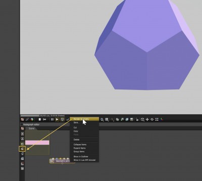

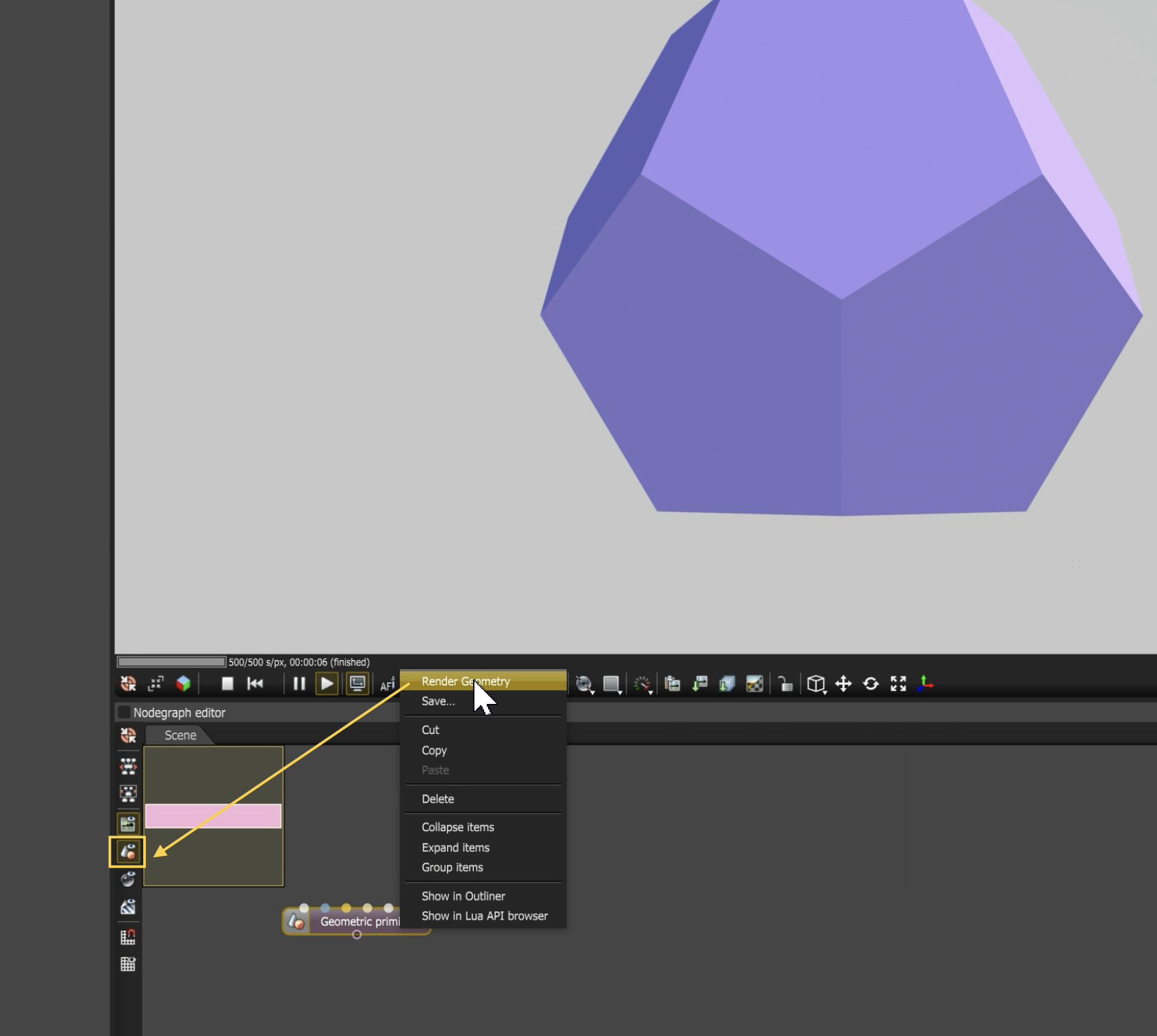

merid888 wrote:I HAVE PROBLEM, I TRY TO USE THE STANDALONE 2020.1-RC4 VERSION AND BY IMPORTING THE SCENE I SIMPLY SEE NOTHING IN THE RENDER VIEW
SOMEBODY COULD HELP ME ? ATTACHMENT FILE OBJ
THANKS TEAM OCTANERENDER
Try adding a RenderTarget.
Render Target is the best option, but you can also right-click on the geometry node and chose Render Geometry.
Or enable the icon in the Node Graph that allows to render a geometry node, as soon as selected:

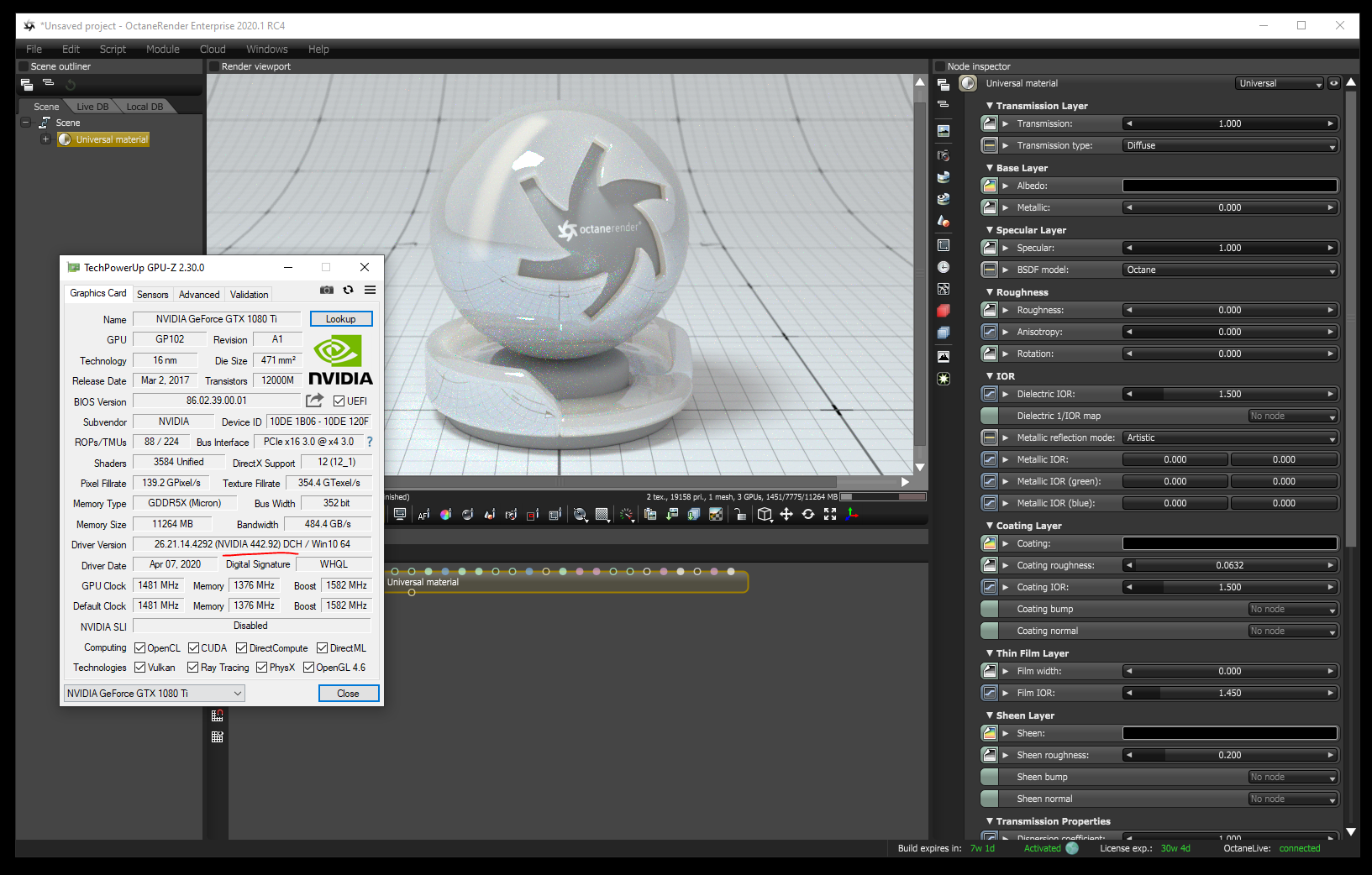

Which kind of Nvidia driver is installed?
You need at least a version greater than 435.80. I’m currently using Studio 442.19.

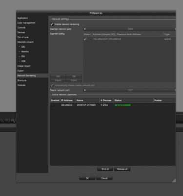

I’m not deceiving, my three friends also couldn’t launch Slave node when I asked them to do it.
Posts: 10616
I don’t think you are deceiving, but I can ensure you that bot 2020.1-RC4 and 2020.1 slaves are running without issues, I couldn’t live without them anymore ;)

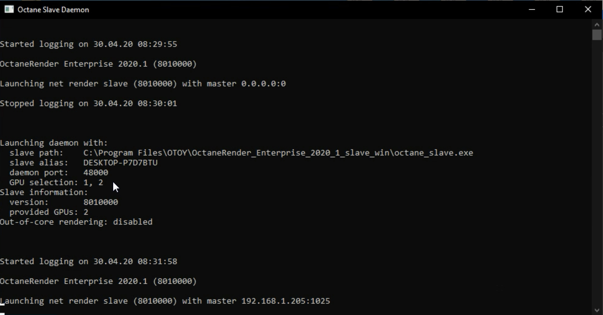

Beppe, this seems absurd, but here's what I found. If I skip the second question of daemon installer: “how many video cards do you want to use?”, the daemon starts and works. And if I answer it by entering a specific number, then the demon does not work.

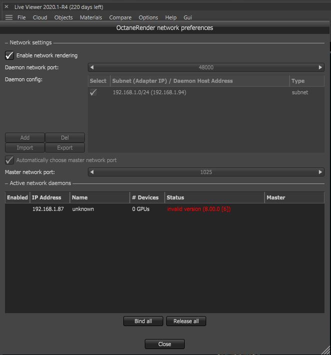

But still, the masternode now tells me that the version of the slave does not match, although both of them are from the last release. Maybe i do something wrong?

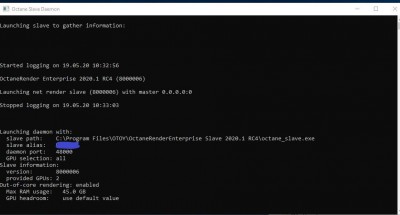

Beppe, can you try install slave daemon with my scenario when you will input specific number of needed video cards?
UPD: I am a little confused in the versions, now everything is fine. Thanks, help is no longer required, but anyway, please check my daemon installation script

About the daemon script, porobably a typo during GPUs selection, I was able to successfully select 2x GPUs:
Please note that you need to enter the numbers of the desired GPUs separated by a comma, and without spaces in between, like:
Code: Select all
1,2,3
Looking forward for your feedback,
ciao Beppe

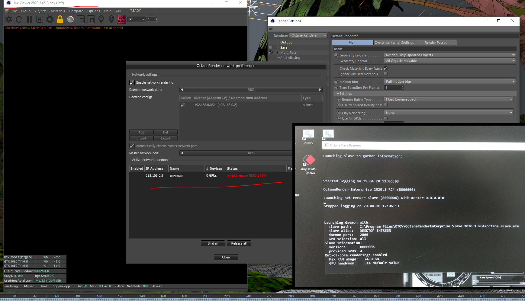

Got the same issue. 2020.1 RC4 C4D plugin and the latest daemon from the firt page of this thread... Rc4. C4D plugin tells me it's an incvalid version. meh. -.-
Workaraound with not selecting specific GPUs didn't work.
Edit: latest nvidia studio drivers on both machines.
edit: added screenshots
