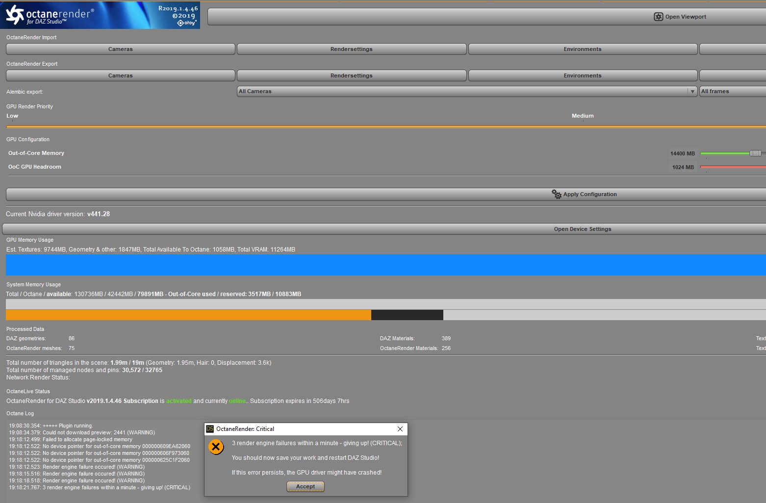

Hi Paul,
I am getting frequent render engine failure. Attached it the screen shot of the Octane's System's panel.
Render Engine Failure
My device and plugin / driver details are in my signature.
Regards,
Rajib
From the log, it looks like Octane ran out of RAM or VRAM. May I suggest trying some different OutOfCore settings. If that does not help, I suggest posting in the Octane Standalone release thread, as these are Octane errors, rather than coming from the plugin.
