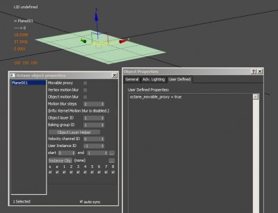

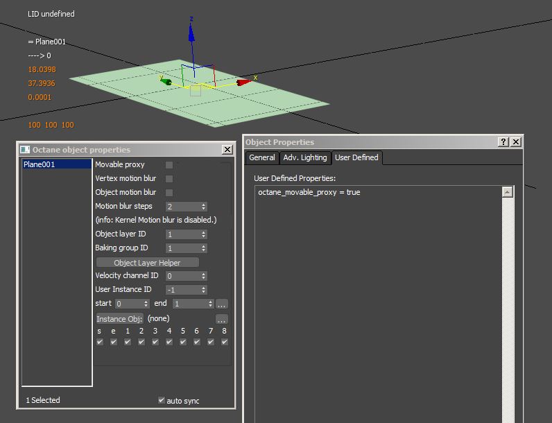

I use a script to set objects as movable proxies for a long time now. And all work like it should.
Now there a problem in "octane object properties", even if the object properties show as an movable proxy, "Movable proxy" is not checked in octane object properties panel.
Perhaps it is due to the fact that when checking "movable proxy" in octane object properties, it is written "True" in object propertie,
and with my script it is written "true".

HHbomb wrote:I use a script to set objects as movable proxies for a long time now. And all work like it should.
Hi HHbomb,
I sent your post to developers.
Regards
Paride

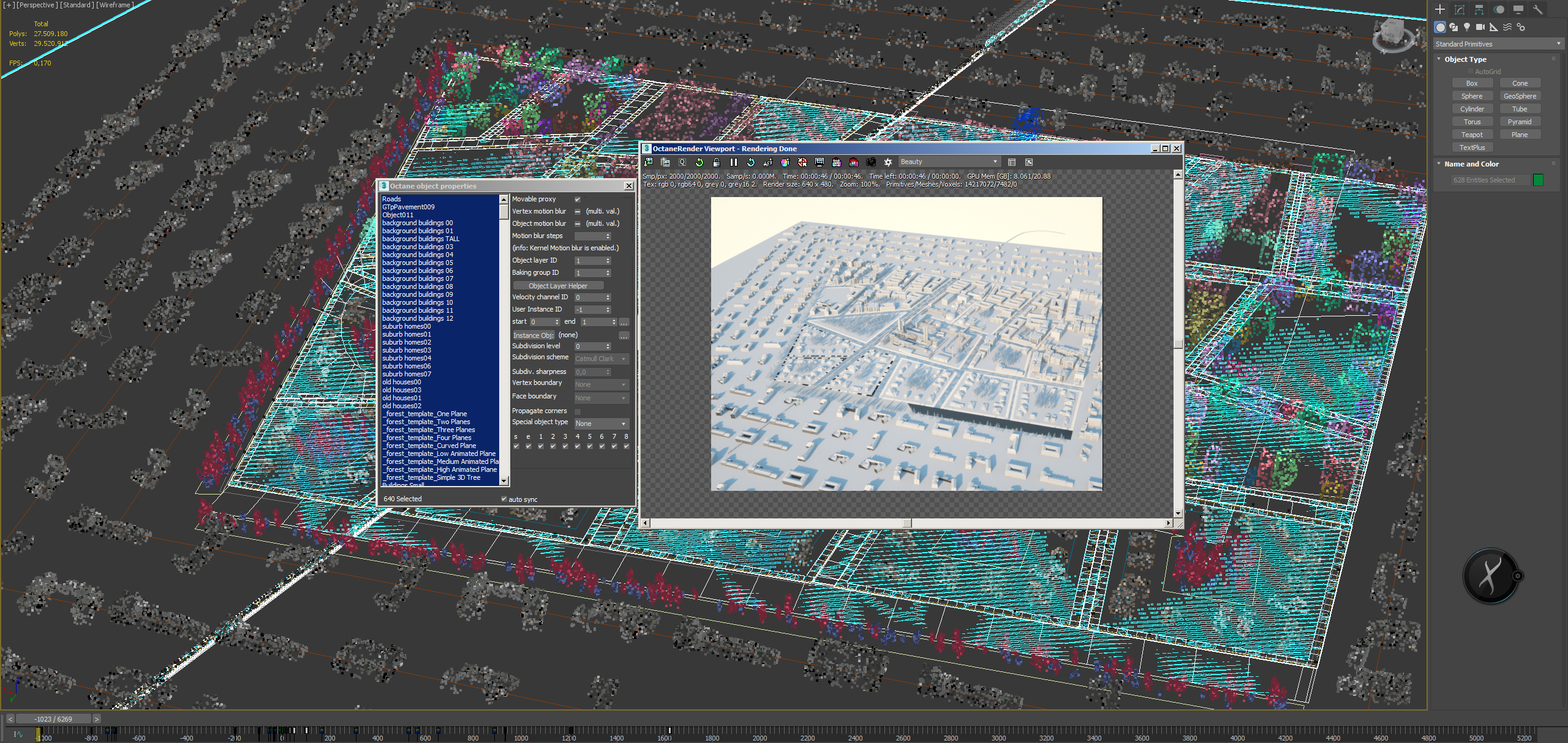

I sent you the scene with slow eval times as PM. Still 35 seconds per frame. Could you guys please fix this bug already.
We also used city traffic 2 in the scene. Link to it http://forum.rendering.ru/viewtopic.php?f=8&t=1428
UPDATE:
Hiding itoo didn't change loading times every frame. The bug points out to the refinery mesh in the scene. It does have a lot of polys but this is a stationary mesh and should be loaded only at frame 1 but for some reason every frame it makes eval times slow
UPDATE2:
When setting this refinery as a movable proxy it evaluates faster. Eval times went from 35 seconds per frame to 6 but then you guys told us stationary objects should not be set as movable proxys. So should we or not set the whole scene as movable proxy? Should buildings be set to movable proxys? Should itoo be set as movable proxy? This looks like a bug
Thank you.
I coilbook,
I set, as I told many time, All movable proxy then:
unchek update anim. geometry
time 3 secs.
Please you always do that, all movable proxy.
especially with big scene and network render.
Regards
Paride

neonZorglub wrote:
coilbook wrote:Hi Paride,
UPDATE:
UPDATE2:
Thank you.
Hi coilbook,
I suspect that some modifier in your big stationary mesh could incorrectly trigger a rebuild; I'm looking into it, as well as the other reported slowdowns..
You could keep those objects as movable proxy for the moment, and in the next version, setting it back to non movable proxy should be more efficient.
Thanks for your scene.
Update:
It is more likely that one or mode object in the scene is animated, but not set as movable proxy.
This forces a rebuild of all objects of the static mesh.
You can disable this by unckecking 'Update anim. geometry' in the Kernel settings, making all non movable proxy really static while rendering an animation.

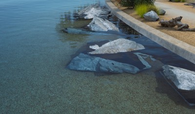

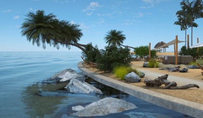

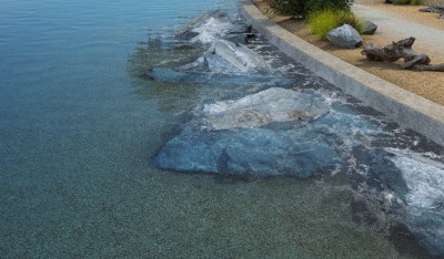

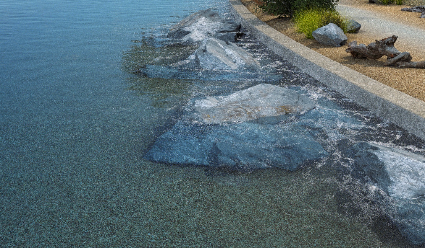

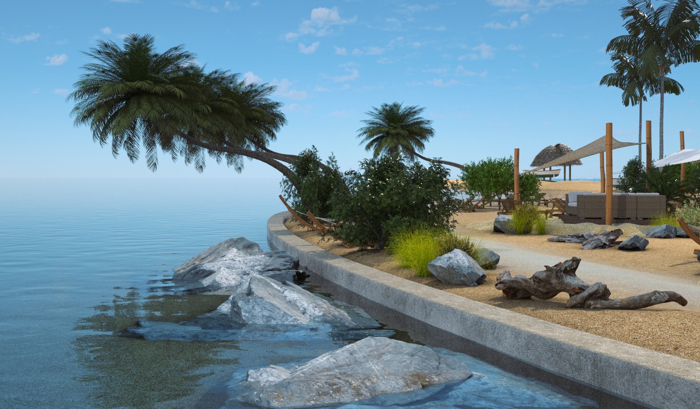

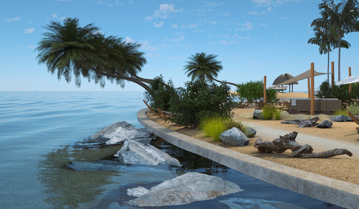

Some weirdnes when using displacement on the specular material, looks like it makes a shell, I did a small displacement map then stretched it a lot (with uv modifier or transform nodes all the same), and made the height quite big, to simulate like a wave .. and the higher it goes the bigger that black band is.. so I made way smaller displacement, the gap is smaller but still there - anyway, check out those, and only happens where it intersects some other geometry
