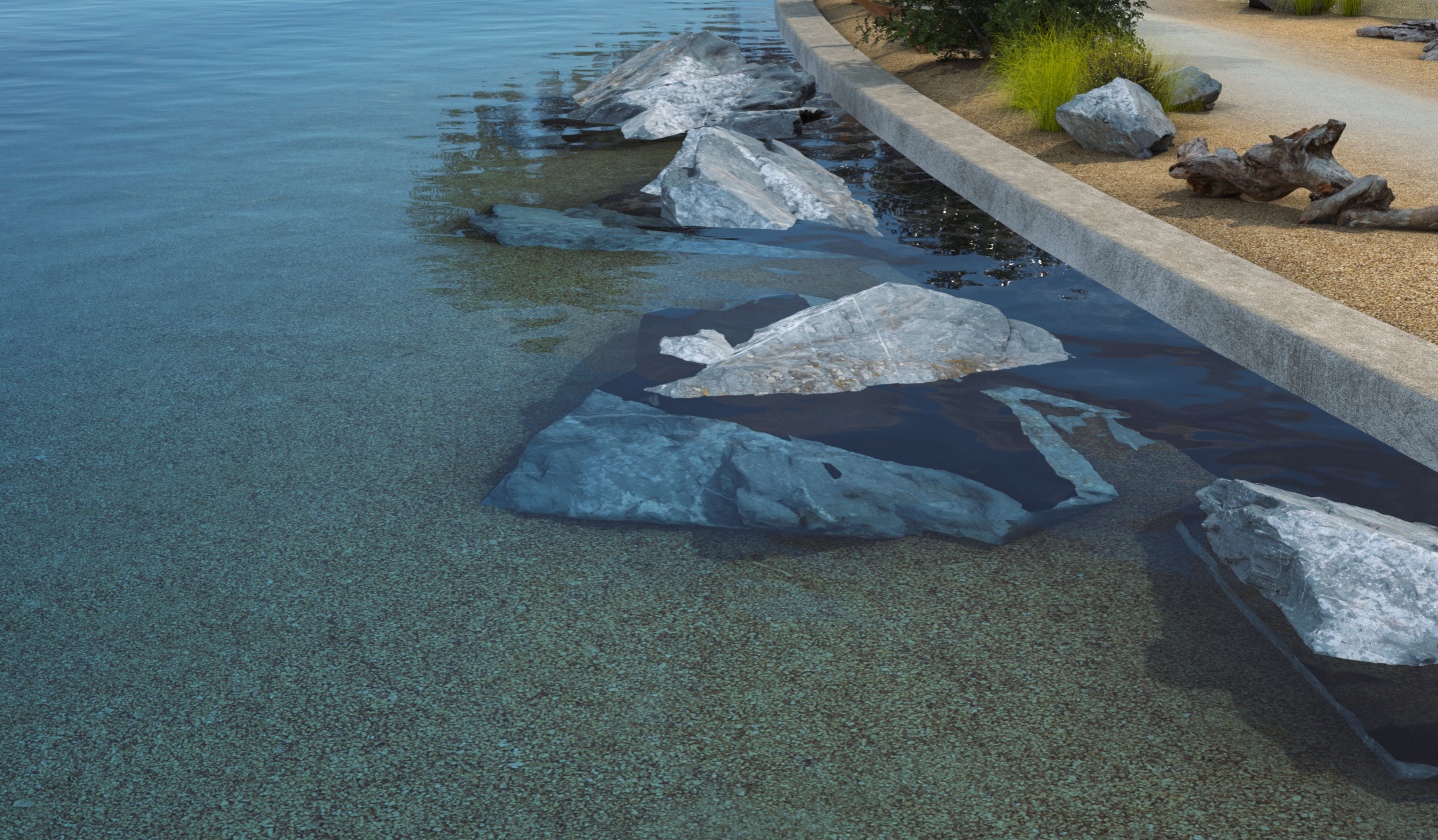

Some weirdnes when using displacement on the specular material, looks like it makes a shell, I did a small displacement map then stretched it a lot (with uv modifier or transform nodes all the same), and made the height quite big, to simulate like a wave .. and the higher it goes the bigger that black band is.. so I made way smaller displacement, the gap is smaller but still there - anyway, check out those, and only happens where it intersects some other geometry
