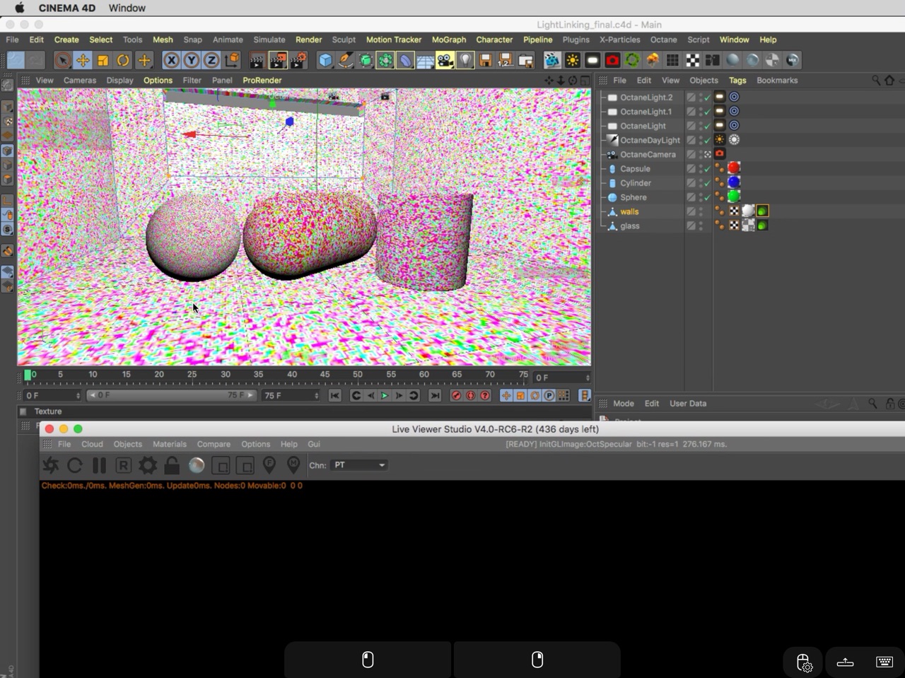

richardyarlett wrote:Anyone else experiencing HORRIBLE weird viewport issues in 3dsmax with RC 6 6.08 ? It looks like my computer took acid. All my texture maps are gone and I am looking and pinks and purples instead.
Hi richardyarlett,
something like that?
Regards
Paride
Hi richardyarlett,
Regards
Paride
my material editor previews have similar jumble of colors

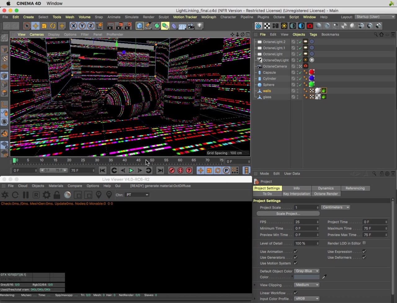

paride4331
Posts: 4002
coilbook wrote:
Hi richardyarlett,
Regards
Paride
Hi coilbook,
maybe you're talking about this?
viewtopic.php?f=80&t=69152&start=20#p348342
Regards
Paride
coilbook
Posts: 3176
in this version all shaded materials disappear from viewport when max is reopened. All mesh is grey. You have to manually click reload button to reload each rgb image to be shown in viewport. Even though SHOW SHADED MATERIAL IN VEIWPORT is already checked.

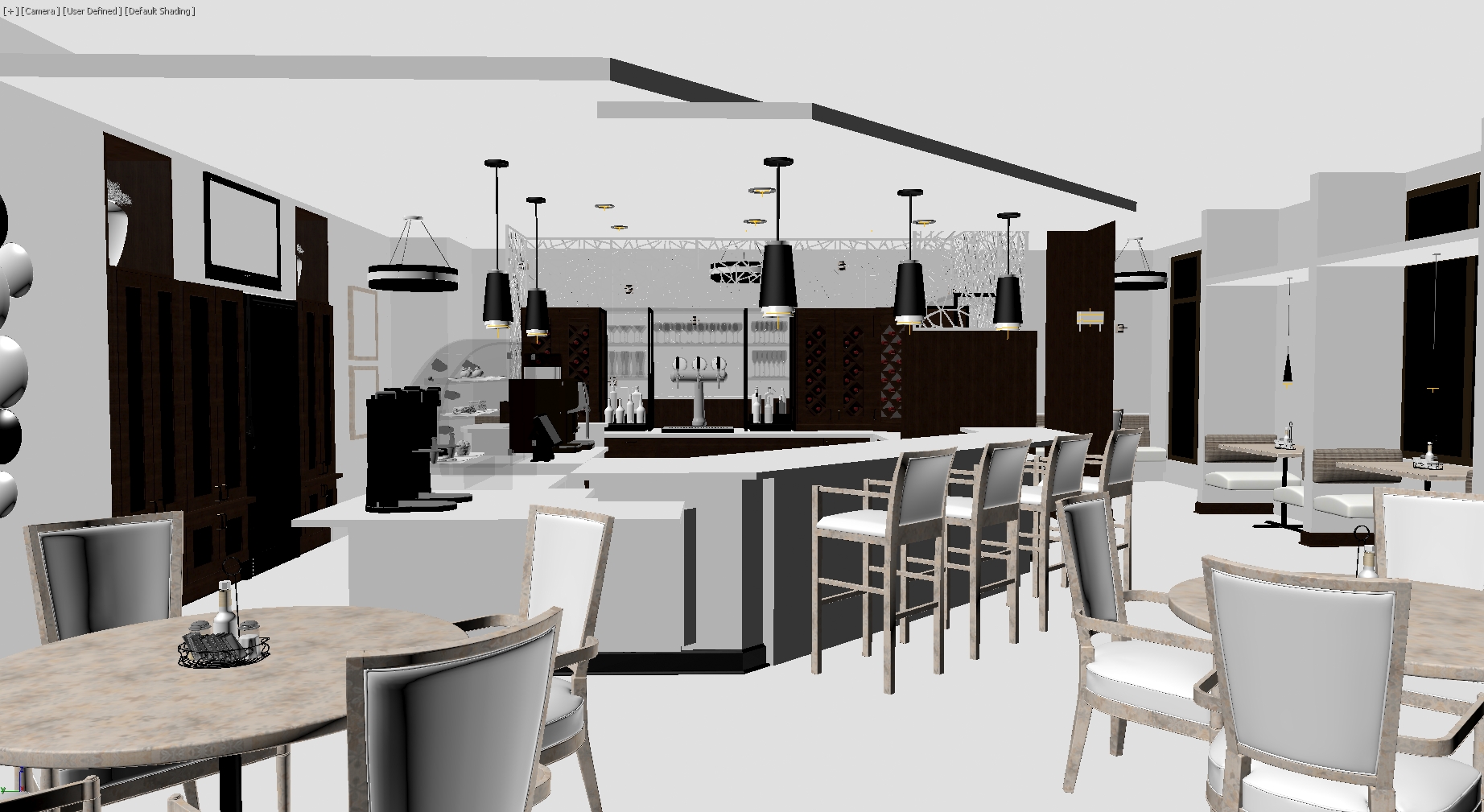

richardyarlett
Posts: 197
Joined: Thu Apr 09, 2015 8:48 pm
YES ! Just like that. What the hell ?
Here is one scene with everything stripped away ?
abstrax
Posts: 5516
Apologies for the material preview issues. It was introduced while trying to work around various CUDA issues and will be fixed with the next release. The problem was that the replacement of a CUDA memset couldn't always be run because it wasn't initialized properly for the material preview rendering and thus the preview result buffer wasn't cleared correctly.
