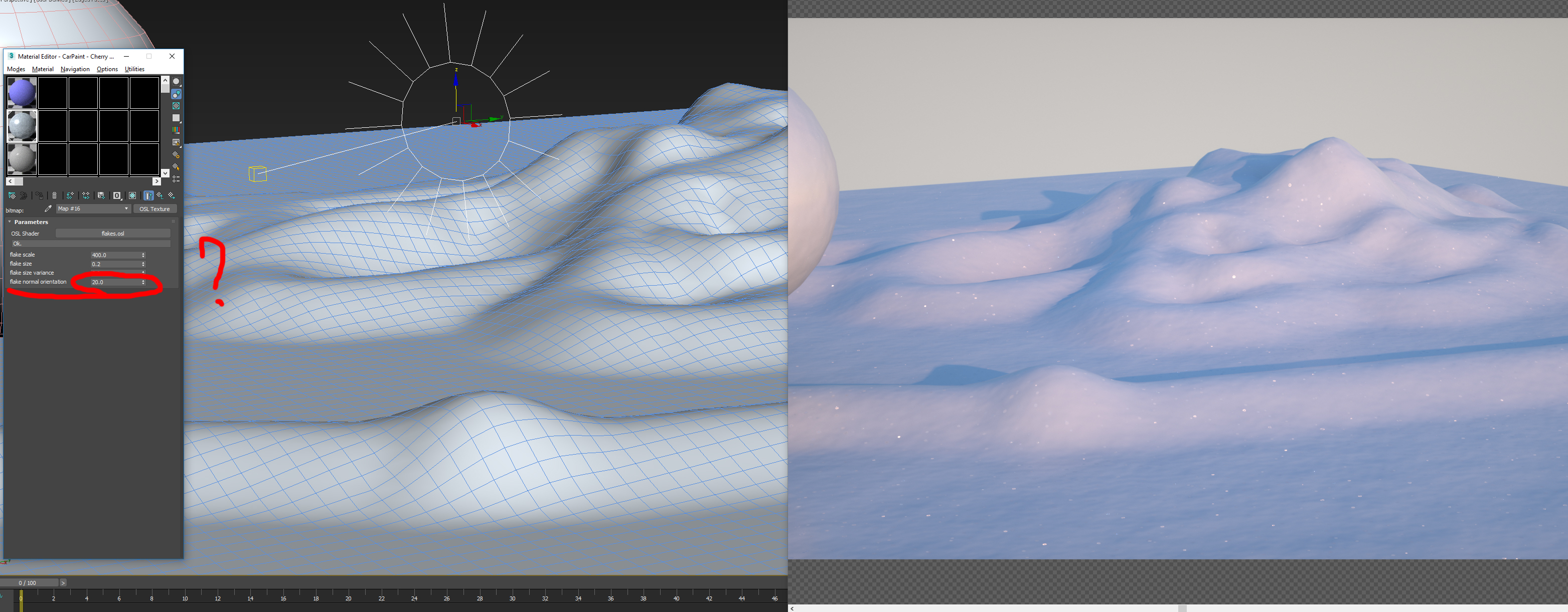

Ok I think I got it I used mix material for the base material osl flakes are inside the normal map.
By the way what is the proper flake normal orientation
and
anyway to add more sparkle? Increasing power in RGB image with osl makes also dark dots visible

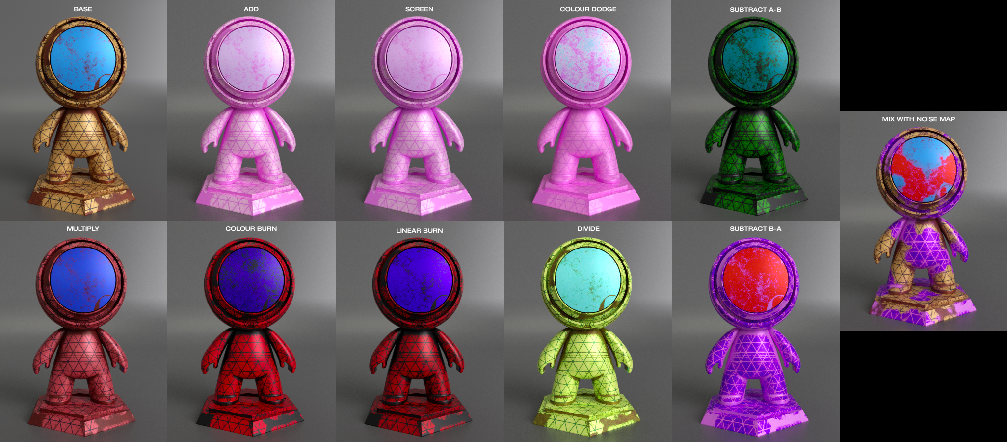

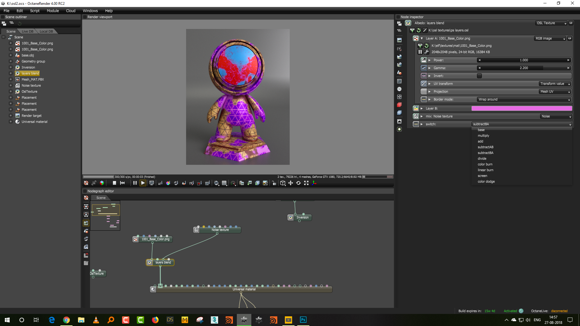

I'm trying to build the photoshop blend modes in OSL. I have gotten a fair bit of them working but I'm stuck on the math for Overlay mode. Could someone help out?
That's the math for overlay
(Target > 0.5) * (1 - (1-2*(Target-0.5)) * (1-Blend)) + (Target <= 0.5) * ((2*Target) * Blend)
When I type (Input color < 0.5) it gives me an error saying "error: Not allowed: 'color > color'"
How exactly do I implement this.
This is where I am at the moment
regards
Rohan
