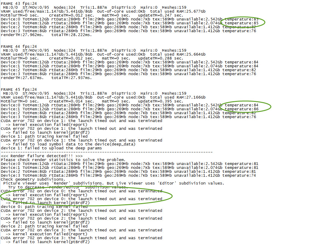

What I am seeing is that renders (in render cue or pic viewer) will start, work for a while and then fail.
The failure takes the following form:
1. Frames stop rendering.
2. Cannot cancel render.
3. Octane is crashed out--will not work without restart.
I thought maybe the crashes were related to doing other tasks while rendering (going to AE to work, etc.--something that used to be okay) but I see the crash outs even if I leave the machine alone.

Please give better information about it.lancemoody wrote:What I am seeing is that renders (in render cue or pic viewer) will start, work for a while and then fail.
Windows 1709 Build 16299.19
Nvidia 388.00
2 Titan Pascals 2 1080's
256GB RAM
6950X Intel
Which scenes gives that? Spesific one?
Any screenshots from crash and some consol log output or bugreport?
Also try older drivers.

Ok, I allowed another crash and here is the render log.
With this crash, I could not quit C4d--had to force quit.
Does this help?
Does this help?
- Attachments
- octane 3.07 TEST 6 171023 202335.log
- (62.38 KiB) Downloaded 354 times
See log outputs. Cuda crashes are not directly related with plugin parts. Your temps are going higher by per frames. It maybe an issue or having an issue to scene spesific. Hard to judge without doing better investigation.lancemoody wrote:Ok, I allowed another crash and here is the render log.
Does this help?

Are you saying the temps are too high? These look like normal temps ~85 for past jobs. I have used the machine for about a year.
