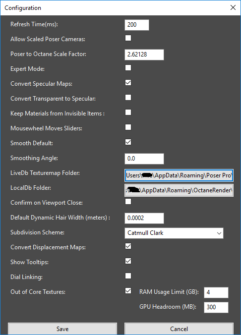

I could not reproduce this issue at all. I loaded a bunch of LiveDb materials and none exhibited this issue. Can you pls tell me a LiveDb material name which causes this issue? Can you also post you OctaneDefaults.py file and a screenshot of your plugin configuration/setup screen.It's kind of interesting, that even the oldest, or randomly loaded materials I have stored locally, or load from the LiveDB, now all have the Normal pin with a Greyscale Color set to 0.0 attached to them, when applying them to a mesh.

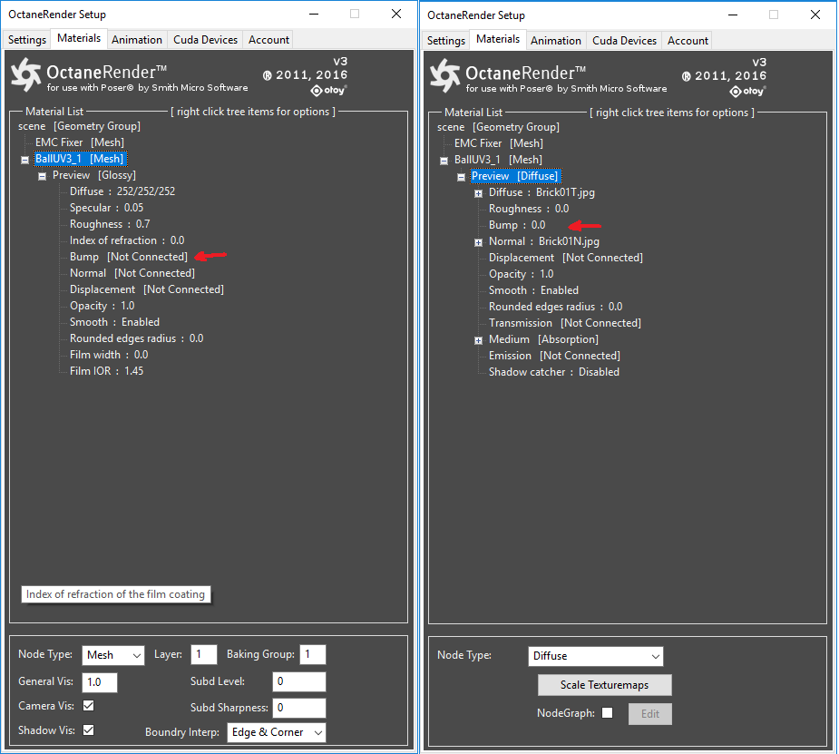

Loading the material "Red Brick", "LiveDB - Absolute Textures - Brick - Red Brick", puts a Greyscale into the Bump channel at 0.0. It was disconnected before.

- OctaneDefaults.txt
- (6.86 KiB) Downloaded 586 times
Bump channels are not a problem. They can be 0 instead of Not Connected. It's only Normal pins where it is an issue.I could reproduce the same issue with the Bump channel as well.

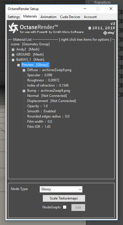

I do not get a 0 Normal value if I load Amethyst Marble. I get the following.Then very 1st LiveDB mat "amethyst marble" (some pink-ish stone mat.) "LiveDB - Organic - Stone - amethyst marble"

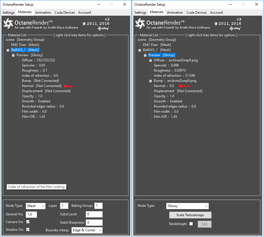

What does the last sentance mean pls? When was "before"? Which plugin version pls?Loading the material "Red Brick", "LiveDB - Absolute Textures - Brick - Red Brick", puts a Greyscale into the Bump channel at 0.0. It was disconnected before.

Sorry for not being clear, in the last sentence. It was really confusing =)
I added two more screen caps to show what I tried to say (on left: how it was initially converted from Poser -> OR plug in; right side is after loading the mat. from the LiveDB)
