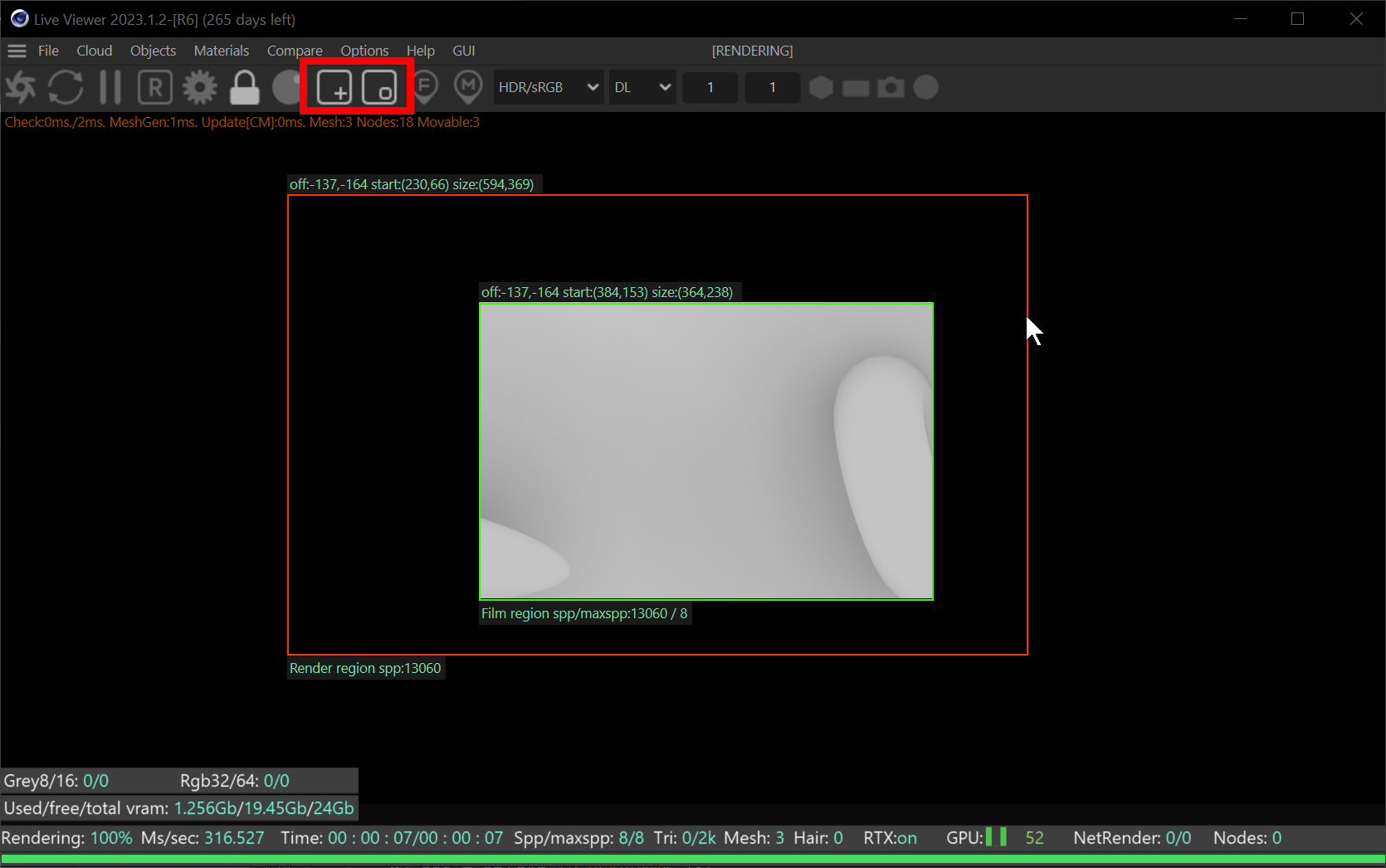

Can I set Live Viewer's Render Region and Film Region using Python? (Button and Region)
You can use Picture Viewer by modifying the render settings.
However, there is no way the live viewer.
C4D R2026 / Win11 / AMD TR WX Series / 256Gb RAM / RTX 5090 FE / 100GbE
Posts: 16068
Location: Türkiye
eyeonestudio wrote:Can I set Live Viewer's Render Region and Film Region using Python? (Button and Region)
There are not any way to change this via script. They are internal and temporal parameters, we don't have no any storage to reveal it. Sorry!
eyeonestudio
Posts: 335
Joined: Fri Oct 18, 2013 5:49 pm
Location: Seoul, South Korea
Oh, I see. Thank you for answer
