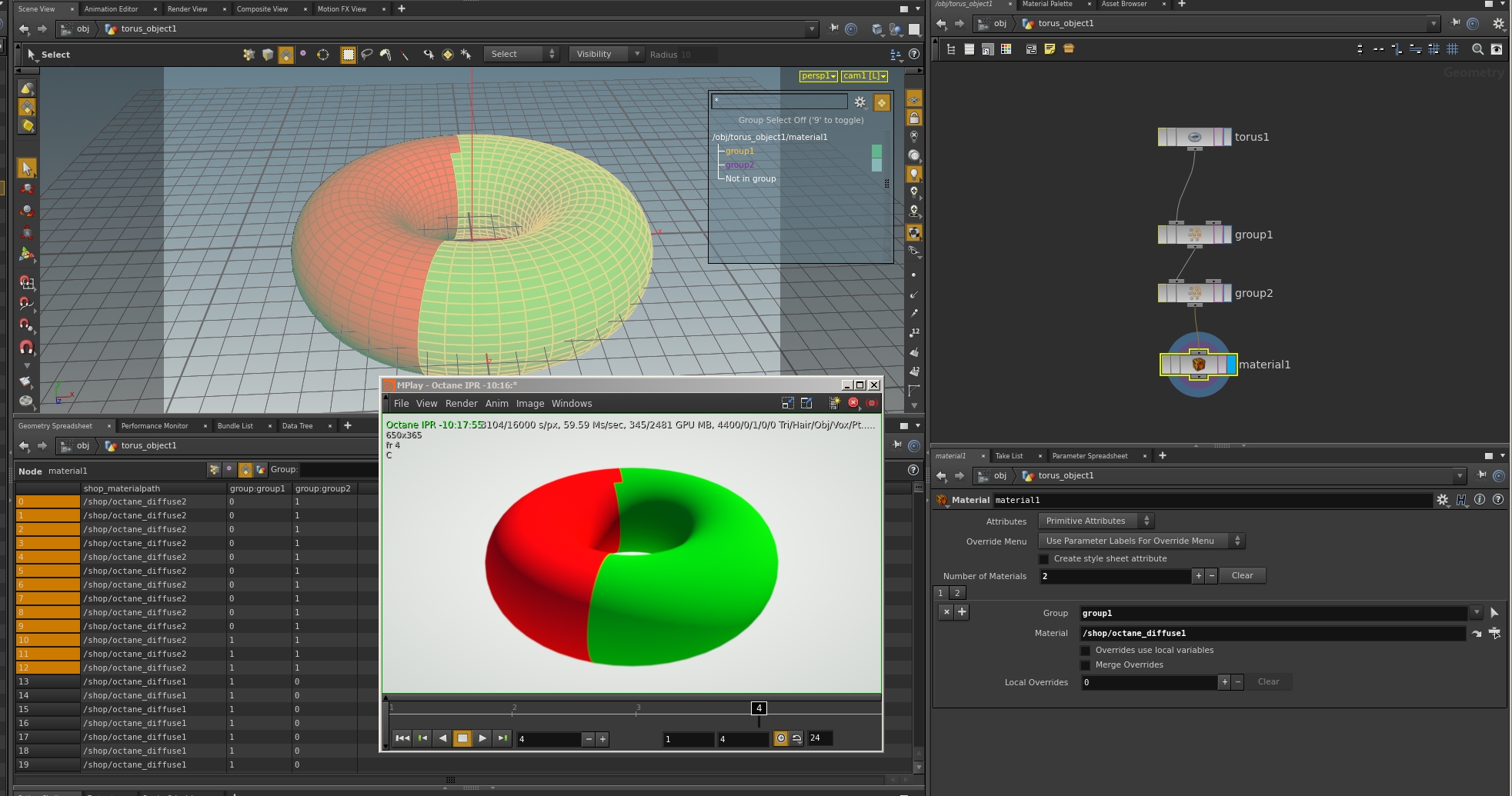

I thought the OR group solution is easy to recreate - but I am doing something wrong.
Can you please provide your example with the red/green torus for download so I
can have a look how the things has to be setup. Maybe this helps someone else ...

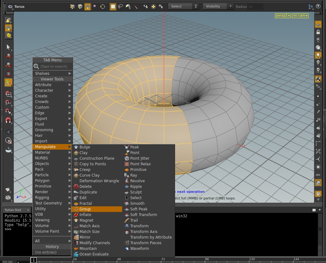

C-You wrote:I thought the OR group solution is easy to recreate - but I am doing something wrong.
It is easy, you only need to select the polygons for a material group, and over the viewport press TAB and select the group feature. Later with the groups done you can add the material SOP node to assign a SHOP material for each group.
-Juanjo

Create groups is not the problem - I did everything needed but it will not work.
What has to put in the material field from the object node? nothing? If I put the
material octane_vopnet1 into everything of torus has same color (its clear). If
I leave empty the group with assigned material1 node (group1 selected) has
no effect - torus is pink.
With particles the same - I think particles itself will not render in OR. But if
I put a copy to apply a sphere and try to put a material node - particles complete hidden.
juanjgon
Posts: 8867
Location: Spain
Attached you have the sample scene. Hope it helps.
-Juanjo
material_groups.zip
(23.99 KiB) Downloaded 249 times
