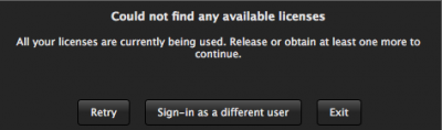

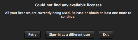

tkkim
Posts: 21
Joined: Wed May 30, 2012 8:19 am
I have 2 licenses.
But, I can't activate 2nd license.
Octane render show me message 'Sign-in as a different user’.
How can I activate two license with same ID, PS.
Please help me.
